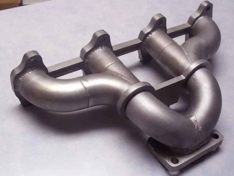

    this has nothing to do with cast one's but this is the one i made up for my landcruiser with the same if not better results to an off the shelf kit and half the cost

    Mmmm. Crusty lol
    If it works, good on you.
    crusty yes but chep and works just as good as any other. gave my bro inlaws VR V6 a run for it's money
    Oh and is just an old 1983 landcriser i'll be making a set for the VP but a proper set

    what you think i am stupid what i'm saying is it may not be the best way to put a turbo on but works just as good
    and proper manifolds are good and looks good but is still not done properly untill you have tuned pipes on it meaning all pipes are the same size from the cyl head to turbo
