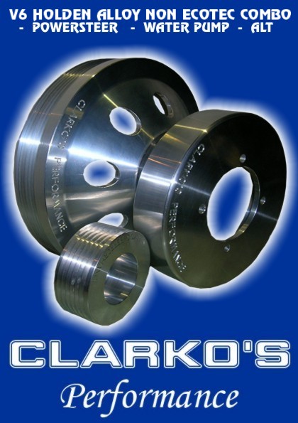

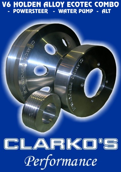

    hopefully we will have some more info in the next day or so. will need about 10 people to make this work

    and a pic for those interested
