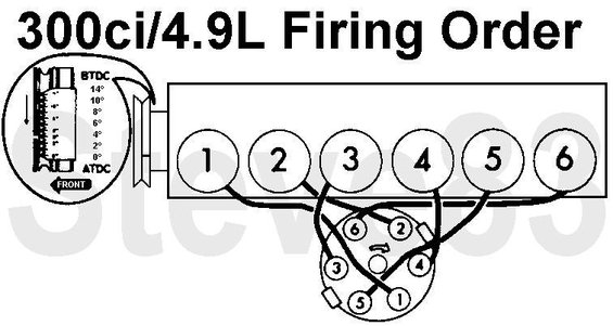

    i copied this order...
    http://www.supermotors.net/getfile/7...ri6.jpg%20alt=

    lol, 4.9L??
    Its a big 6?!
    They must all be a similar firing order/dizzy position on the straight 6's?
    Good effort though, if its running with out misfiring I'd say you've got it right anyway.

    well yer i saw that, but the 'holdenpedia.com.au' or whatever it was said the firing order was
    1-5-3-6-2-4 and it was the same as that diagram so yer...
    ii hope so!
