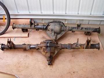

    Umm what shape is the rear cover?(I have a pic just to show you the difference between small and large Sals diffs).
    There was a 2.78 rear ratio for commodores, mostly the auto models got them. Now is your VH a 202 form factory?. The diff you have atm could be either 2.60 or 3.08.
    To convert you diff to disc brake all you need is the rear rotors, brake lines and hand brake cable.
    As for LSD diff it could be. It should have a tag on the diff filler hole.
    Oh and picture time!!
    The diff on top of the pic is the proper 10 bolt Sals, the one on the bottom is the smaller 8 bolt 6 Banger diff.

    well, i only have pictures to compare your pictures to, but i think it looks like hte top one in your picture. it has the same axle mounts, they differ between the two yeah? and also i am trying to compare hte side supports on the diff....

    Well I can tell its NOT a 10 Bolt diff at all, its just a 6 banger/253 diff mate. But still good for parts!

    A big Sals diff is one tough diff, only the big 308 powered commies got them. The 6 banger diff is a little weak though.

    some 8bolts diffs was LSD, the SL/Es had them for sure, option on other models.
    And what gave it away? Thats a secret!! nah when i had a look at the one on ebay and looks the same as the bottom one in the pic i posted above. The 10 bolt is one big diff.
