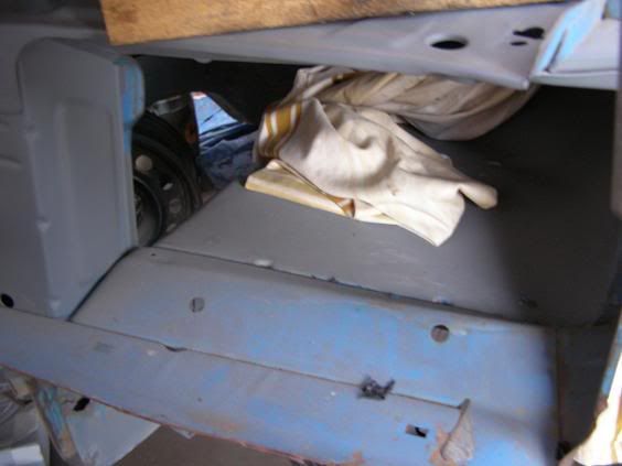

    Well, after a quick 5 min job, here is whats under my VB. Before one says its been in a front end bingle, nope never has.
    And this is dads VB project, again never had a front end bingle
    And lastly dads second owner VB has had both headlights out, no numbers there either.
    So 88greenVN, perhaps someone else put the numbers under the headlight in the VB you had. The body no. factory is pressed into the rad support, also pressed into the build plate.
    This is standard fitments on VB-VH. Although some VHs have them on the left hand strut tower.
    Hope this helps anyone else with a VB/VC/VH Commodores.
