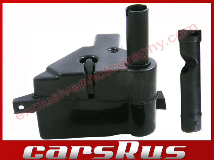

    Have you checked the overflow container for leaks ?
    Fill it up with water and observe what happens after an hour or so. No need to run the car for this.
    With a small plastic tube you can siphon the water out and replace with coolant to the correct level.

    Ummm, I did add a fair bit of water in to the over flow container but probably not enough to test it the way you mean.
    Good idea.

    It is not possible to over fill the cooling system but the reservoir can be over filled. No problem though as soon as the engine reaches operating temperature and pushes more coolant into the reservoir, the excess will overflow so next time the engine is run you will find the reservoir coolant level has returned to normal unless something else is wrong
