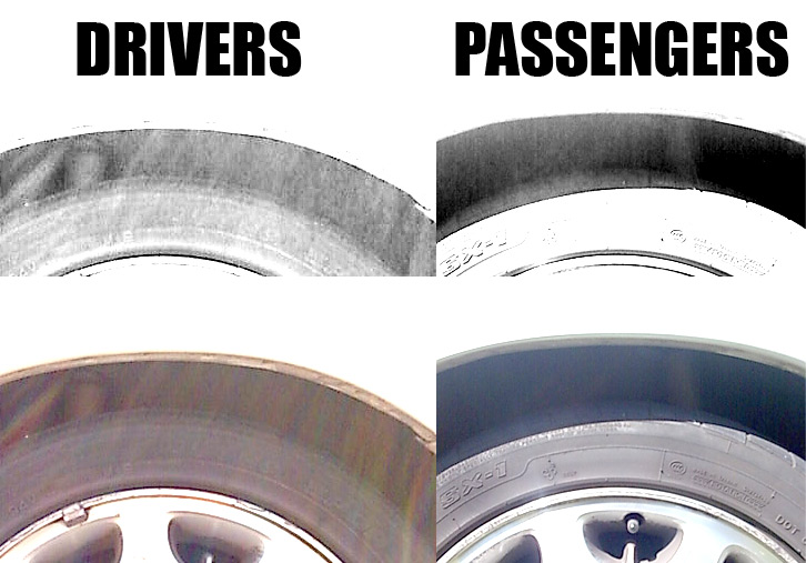

    Just looking at the car it sits lower on the drivers side with noone in the car. I took this photo of the rear wheels to compare -
    The top photo is just desaturated and levels corrected to make the tyre stand out more in the dark wheel arch. It's only sitting slightly lower, but with my considerable weight in there it sits a bit lower than that (had another photo taken).
    I'm going to call my mechanic again tomorrow and see if he can check it out.

    OK so my mechanic is officially stumped by this noise.
    He got under the back and poked, pulled, prodded, shook, pry-bar'd and jiggled everything he could think of to see if it was naffed and couldn't find anything. No sign of anything wearing, said the bushes in the back end all look nearly new. The auto leveller isn't connected because I have aftermarket shocks in, but he said the suspension and springs are fine.
    I left the mechanic's none the wiser and with no real course for action now other than finding another mechanic to listen to the noise and try and find what it is.
    What a pain in the arse!
