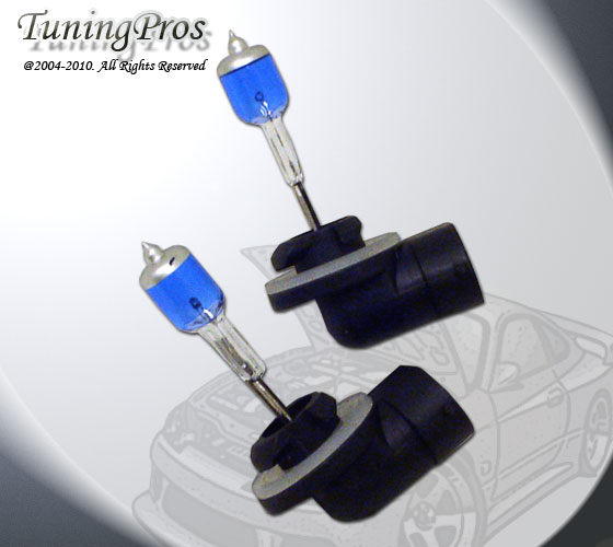

    Well ive found a site that supposedly sells some super white ones and have had a 30$ gamble to see if they are actually different
    881 H27 12v 55W Super White 1pc Box

    Ah well for $30 ill give them a try, I didn't really want to go HID in the foggies. Thanks for your help mate.

    O.k I put in the new globes and they are whiter than the old ones.
    New globe is drivers side, old globe passenger side.

    Night pic:
    They are the same white as my headlights which is what i wanted
    Also for anyones future refernce the H27 globe for these foglights is more commonly known as an 881 globe.
