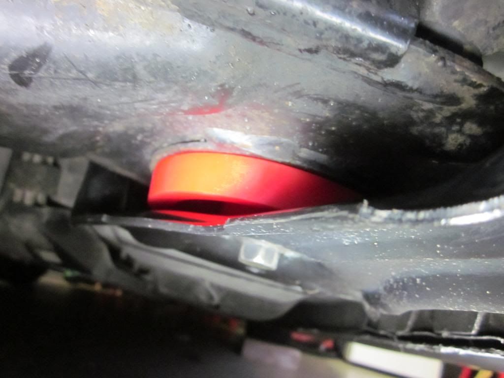

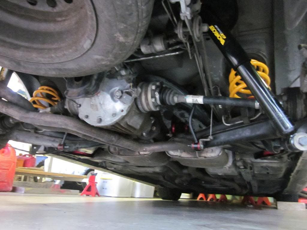

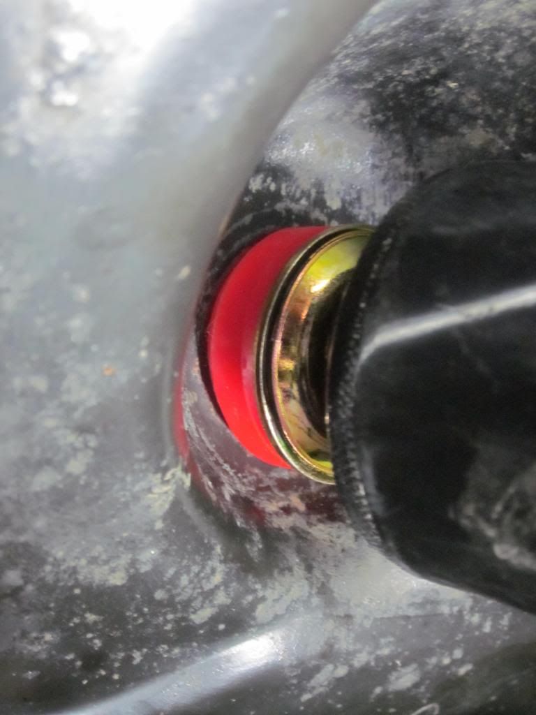

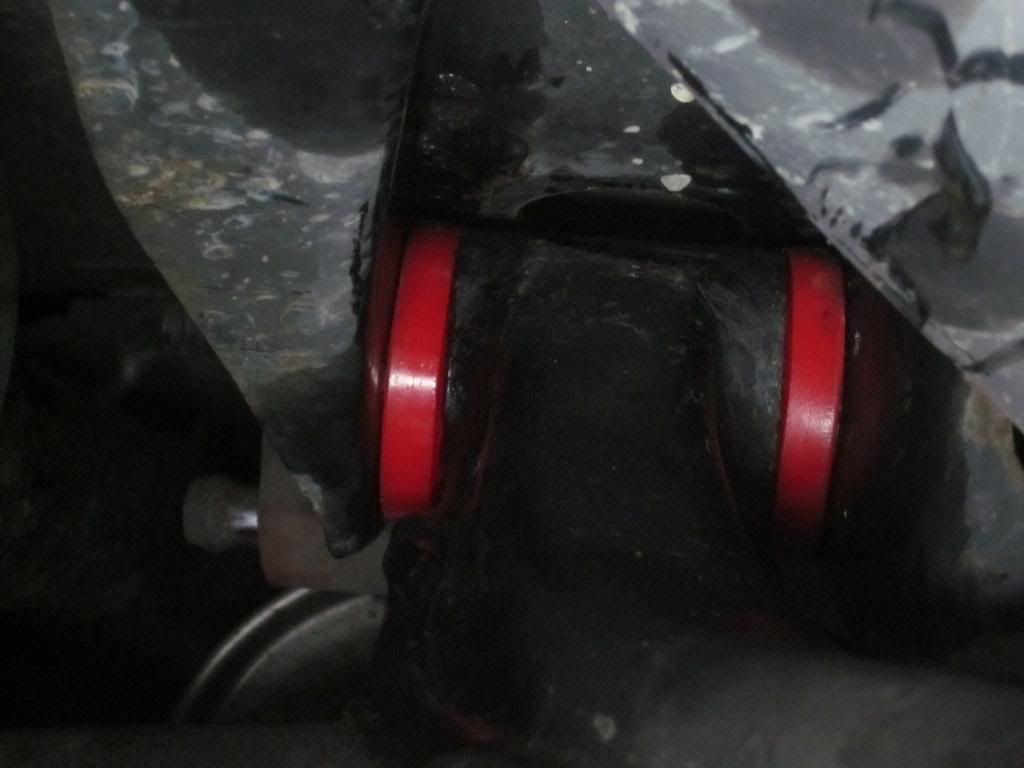

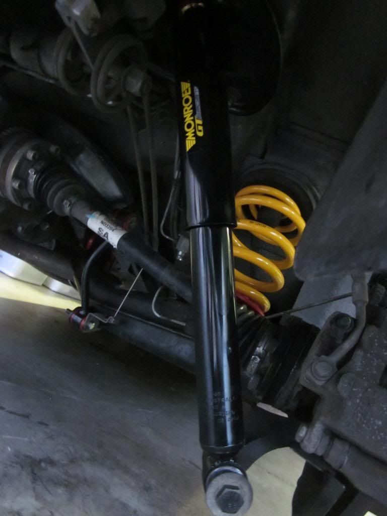

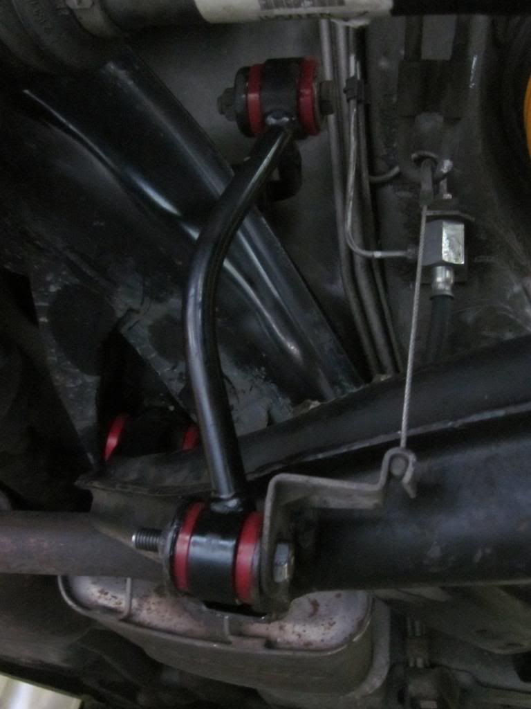

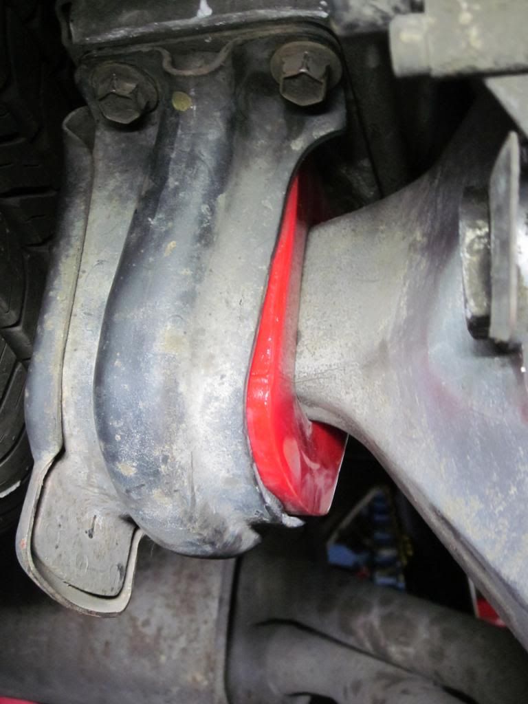

Just some pics of the Nolathane bushes in the rear end:

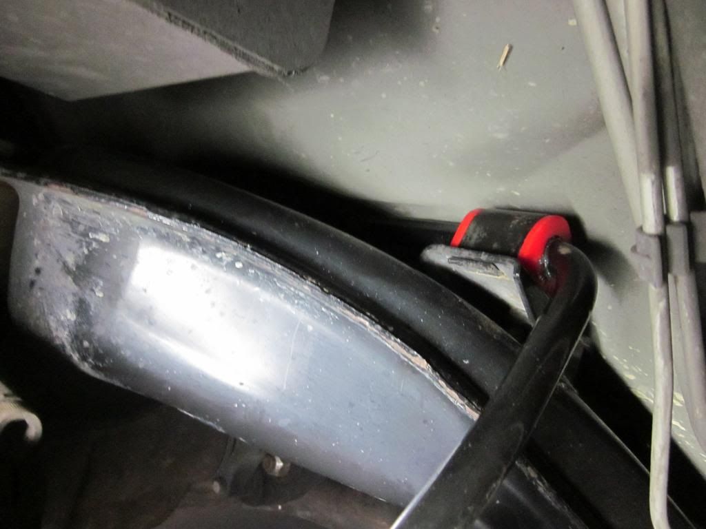

Sway bar linkages bushes x4
Top shock mount bush x2
Rear control arm bush x2
Sub frame mount bush x2

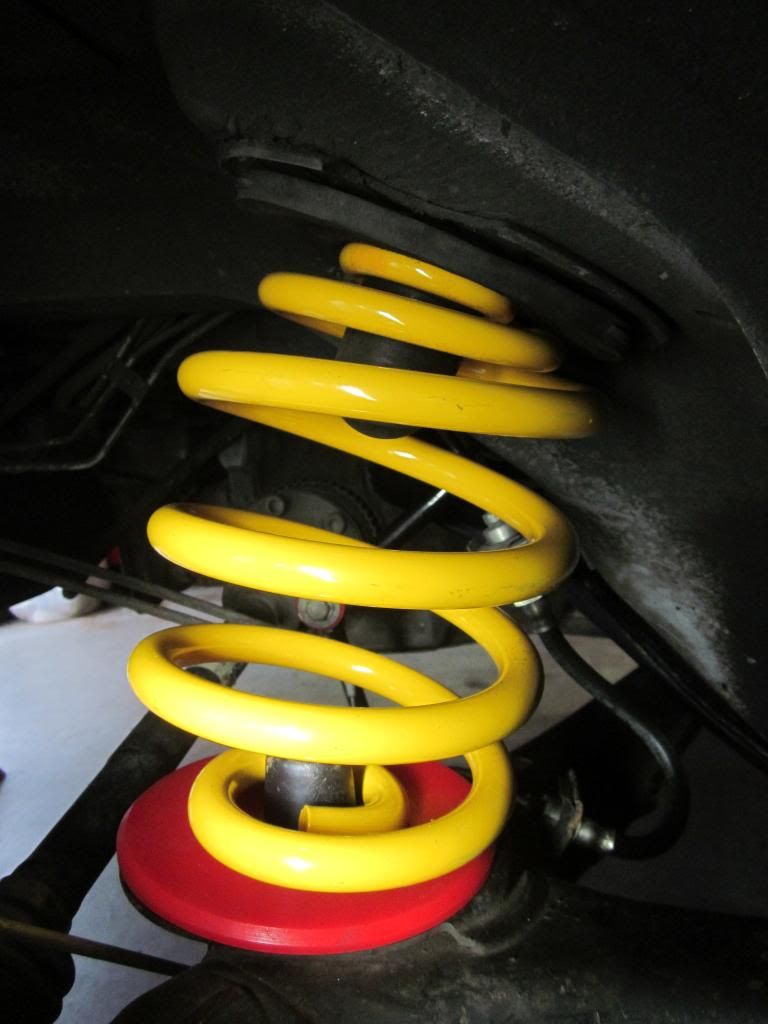

Super low King springs with lower Nolathane spring seat x2
Diff insert bush
Sway bar bush x2
Monroe GT Sport shortened shocks x2

One question though, if you're spending this much on it, why run Monroe/King combo rather than something more compliant like Holden FE2 and some Koni? It wont be quite so harsh over bumps that way.
Just my 2c, but otherwise it's a good job you're doing and its all being done properly rather than just chasing power first and waiting until things break before fixing.

We did similar to this in my sons VY but the ride is so harsh compared to mine and like "soslowbro" said to do, I have HSV luxury springs with Koni Yellow sports adjustables and it gives a great ride and control without being harsh.
I just fitted bigger sway bars to handle the roll.

The Nolathanes are the hardest to so im glad that's done, I was just wanting to put some different springs and shocks in it for now cause those will be easy to wack out later on and put some better ones in if I wanted plus I'm sort of low on of coin lol.
Nice work changing everything we feel very tight, like new when finished just a lot harder.
Yeah cant wait to throw it around corners, Will probably do that later on, just wanted some different shocks/springs rather than the factory ones for now. Once the front end is done I want to focus on putting my Di fillippo headers on and making up a new 3inch exhaust so I have diff dumpers.

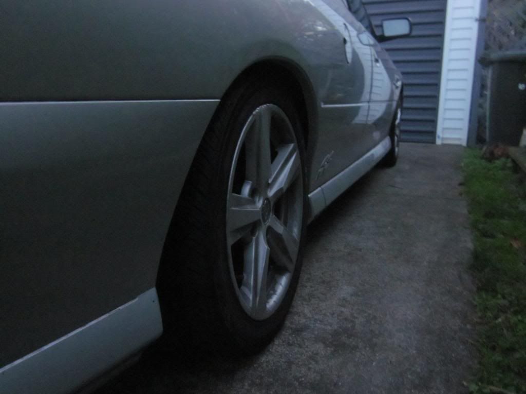

Looks beautiful that height. Lowest point got to be under 100mm yeah?
