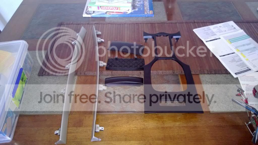

    OK guys my plastidip has arrive, here is my plan ...
    So whats going to be red:
    >Dash spears
    >Centre of dash (the black bit not the grainy bits where the hand brake is)
    >This same bit that runs down through the back aircon vents.
    >Red/black HSVi steering wheel should be here soon :rockon:

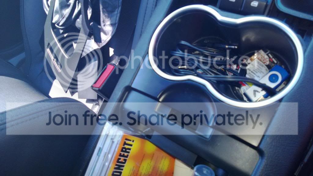

    So here is my issue I don't know how to get his part out ... any ideas guys ?

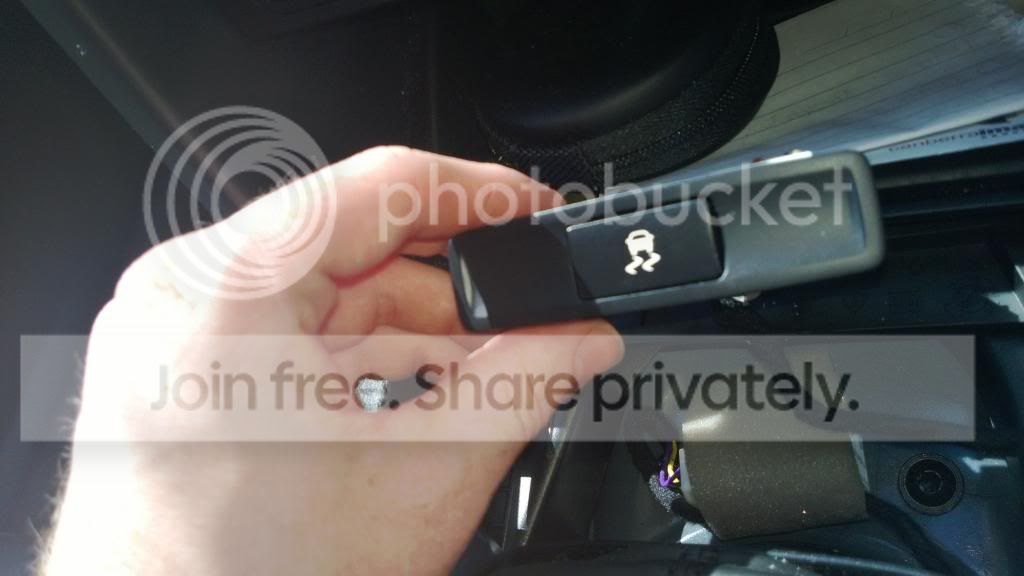

    Also opinions here please, because i can get the power window switch surroun off to paint, should i paint it or leave it as the ESP button is going to have black surround because i can't get the buttons free of the surround. And I also wonder if I should continue this theme up the head unit, because i know i can take the black surround of the head unit and paint it but just leave the buttons black .... to much ?

    IMO the flat part of the console (around the switches etc.) is very plain, wouldn't hurt to paint it. The switches would be fine kept black. Oh and CLEAN OUT YOUR CONSOLE!!!!!

    PLease they are all my free things i've won at maccas monolpy ! Also my AUX cord lives there because im not lucky enough to have a Series II

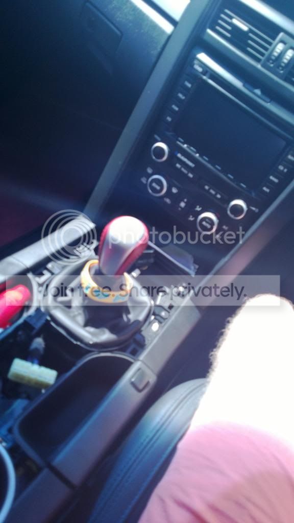

    What's with the cawk ring on your gear stick? You trying to make it longer :p
    Car looks great. Nice work!

    The small trim piece behind the cup holder is just cipped in with a clip either side. Use a plastic trim removal tool (or be careful with a flat head screw driver) and pry it up from either rear corner, then the other. Same plastic clips that hold the front section in, to give you an idea.
    edit. Incidentally, that is the same trim piece that allows access to the hand brake cable tensioning screw ;)

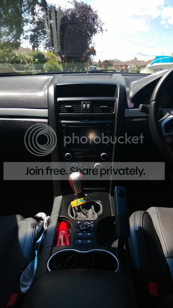

    Plasti dip attracts dust like mad.. Good luck using it on the interior.. For interior I'd just be buying some cheap vinyl..

    I don't know if I want gloss or matte look atm, I'm really liking how it came up and there is no other gloss in the car so it might stand out ?

    personal preference, but I find that when painting black you go gloss everything else matte.
