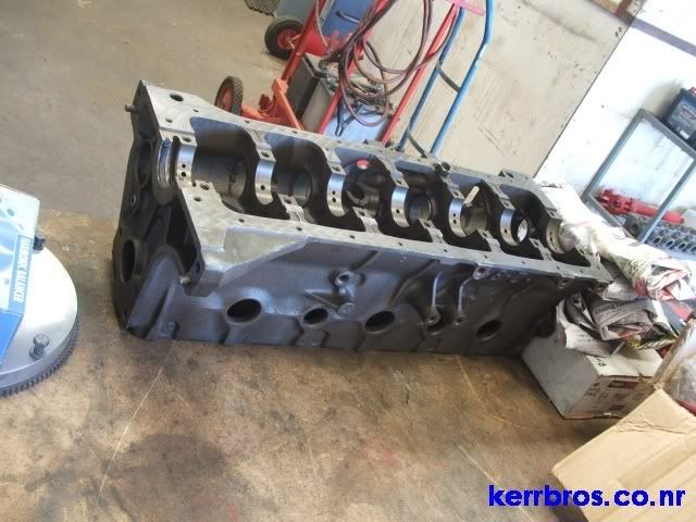

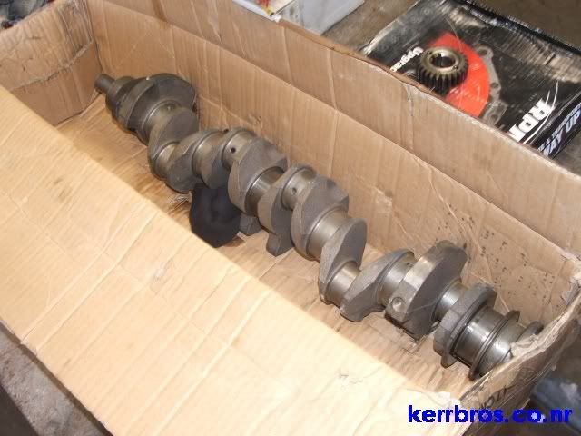

    Went out to Richard's Motors 2day and sussed out my motor coz they got it back yesterday. I got a few things done including getting the bottom end balanced.
    I always thought that to balance the gear, (ie, crank) ya weld bits on, but mine has had holes drilled in it, is that the right way of doing it? My flywheel also has a few holes drilled in it. Not all the way through, just part way.
    I'll get some pics up soon to show ya's :thumbsup:

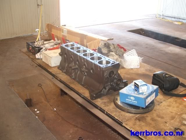

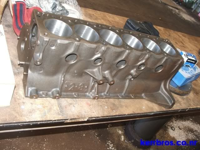

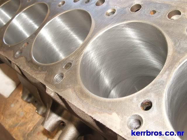

    Here's the pics I took this morning:
    You can see the holes in some of the pics.
  3. stroke it
    stroke it New Member
    Feb 3, 2007
    VC,VK, VN
    Well thats the way theyre doing it, theyre taking the lightest point of mass and making everything else equal. Its cheaper in the sense that adding mallory metal is more expensive. Nothing wrong with a slightly lighter crank.
    Theyve done a good job on that block by the way.

    Thx mate, I just thought that by drillling holes it would make it weaker. I'm not sure where the boring and balancing was done. It was suppose to go to Chris Milton but they sent it to someone else in Adelaide, not sure who.

    nah they do it in a way that it doesnt weaken it. when i was balancing impellers for the water corp we actually used a grinder , so your lucky there ;P

    Chris Milton quoted $192.73 to bore the bores out 130tho to fit my new 186 flat tops, and to balance the crank assy he quoted me $169.09.

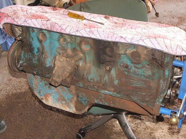

    Here's wat the block looked like b4:
