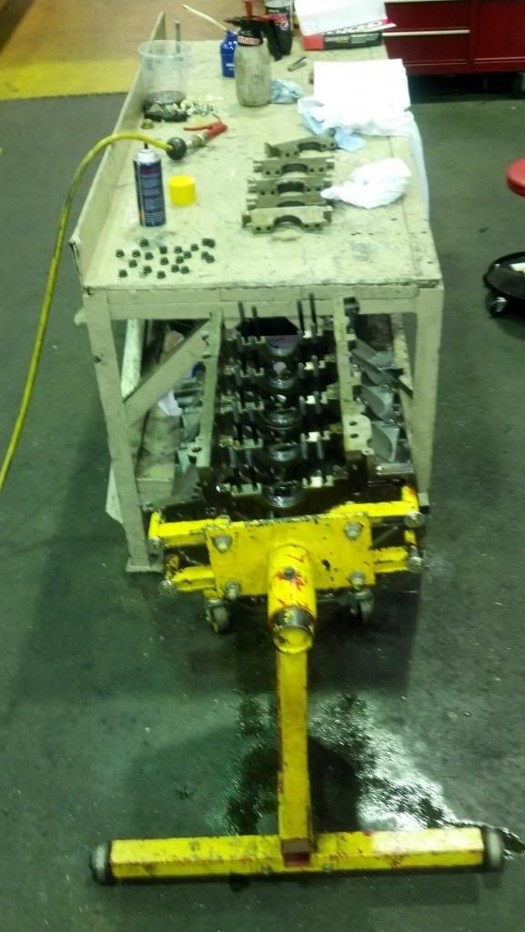

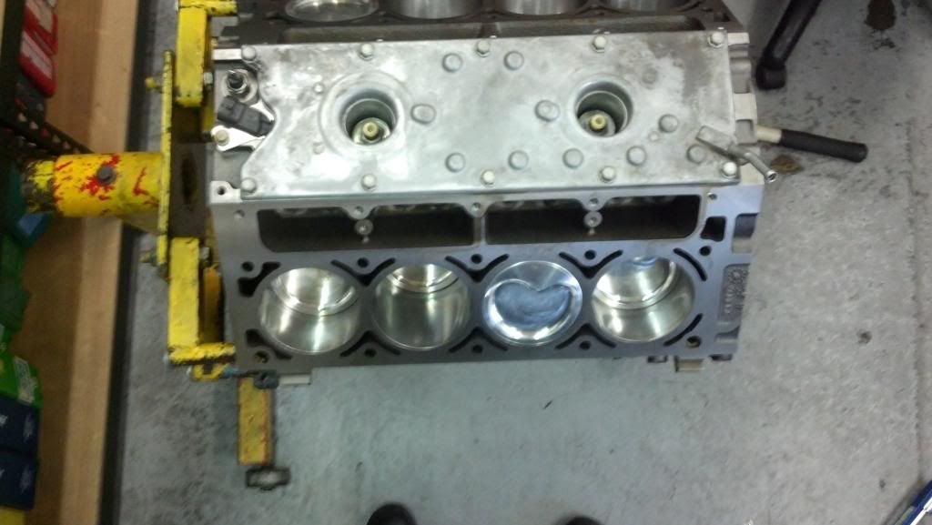

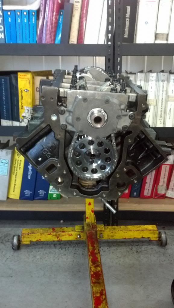

    i didnt take too many pictures but most of the bottom end is complete. crank is in 7 pistons are in and all turning nicely. ended up bending one part of the oil control ring on the 8th piston after having to swap pistons around so it could clear the counterweights on the stroker crank. the cam went in. and i need lifters to check that the cam timing is good. so i ordered lifters and a new melling high volume oil pump hopefully i should see them this week and a set of ls3 heads.
    pistons with rods on them
    about to install the crank
    crank in 7 pistons in and cam in. front plate and sump dummy fitted to stop **** getting in.
    me using the overkill overhead crane to hold the motor while i put the rear cover on.
    so thats where im at for the moment. more pics to come next week when more parts arrive and more work is done.

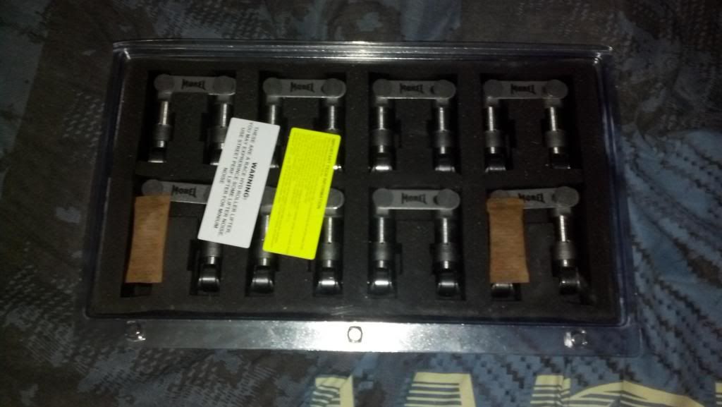

    this week i got my morel race tie bar lifters and melling high volume oil pump. but ive been having a bit of trouble sourcing a replacement ring so ive sent a sample of what i need back to come racing and they should send me what i need next week and i can finish the assembly of the bottom end.
    this warning is on the packet? has anyone used them and knows how noisy they are? not that im too fussed just like to know what to expect.

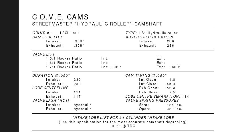

    well i thought id write up a list of the bits for the engine so far
    LS1 style cast iron block with 4.0inch bore
    COME racing 4340 Forged 408 stroker crank
    Come Racing Billet H beam rods and arp 2000 bolts
    Clevite H series bearings on the mains and big ends
    Diamond racing forged 4.005 pistons with a -24cc dish and chrome rings to take the boost
    COME Cams turbo cam
    Morel Race series hydraulic tie bar lifters
    Melling High volume oil pump
    Rollmaster double row timing chain
    ARP main studs, head studs, crank bolt, cam bolts, cam retainer bolts, rod bolts
    Cometic headgaskets to bring it to a 9.0 compression ratio
    LS3 CNC heads with COMP Springs package
    thats all i can think of for now. will add more as i finish off things
    here's the cam card for anyone interested.

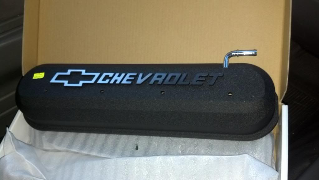

    well ive got a few more parts to add here.
    i went out to eagle on saturday with dan and ordered a set of ls3 heads and picked up some rocker covers while i was there. heads come this week afaik and then need to order some stronger springs for the heads as my cam is too big for stock springs.
    not too long now :)

    another update.
    the ring i was waiting for showed up from come racing, so i decided its best time to put the 8th piston in. put it in and checked all the torques of all the bottom end bolts. all good so far, got the crank scraper installed and the oil pickup tube on. just need to line up the front and rear covers then the sump can go on :) and bottom end is complete.
    put my high volume melling oil pump on with the spacers to clear the double row timing chain and all is sweet
