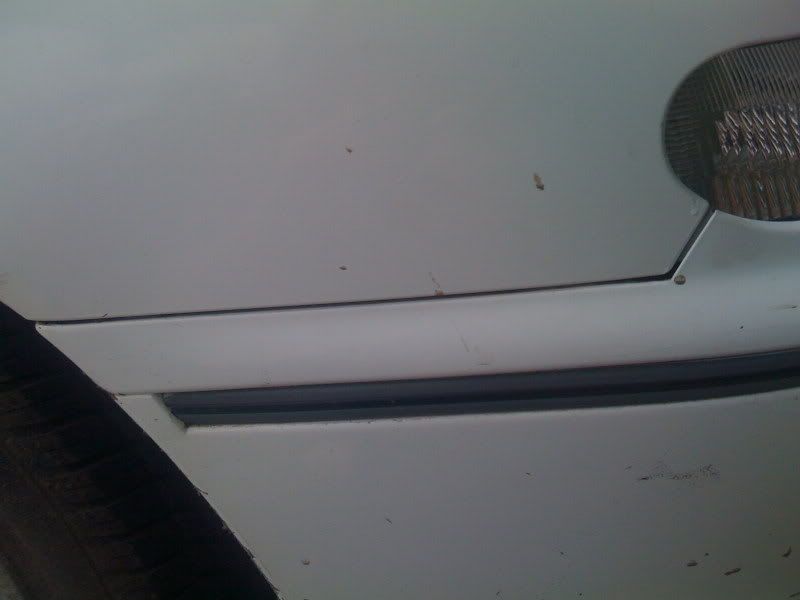

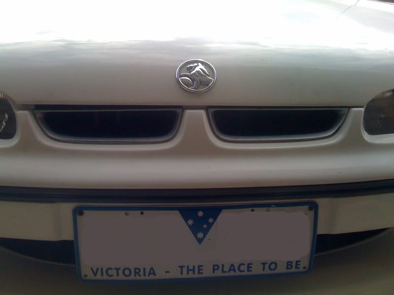

    I took my car to get the front end fixed as a mate hit a gutter :supersad:
    And a few weeks later get the car back but noticed that the front bumper is a bit crooked
    Anyone know how to fix this?

    The pix makes it a bit unclear but from the first pix it appears the bonnet stop rubbers (one each side at the front) are not evenly adjusted - the one on the pass side needs adjusting up to allow the bonnet to sit higher on pass side and lower on drivers side...then the guard may look better.
