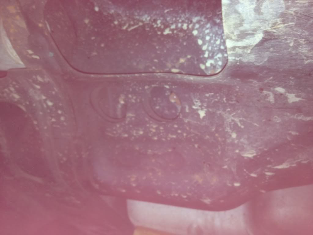

So iv just done changed my engine mounts today, as mine were kinda shitty as you can see:

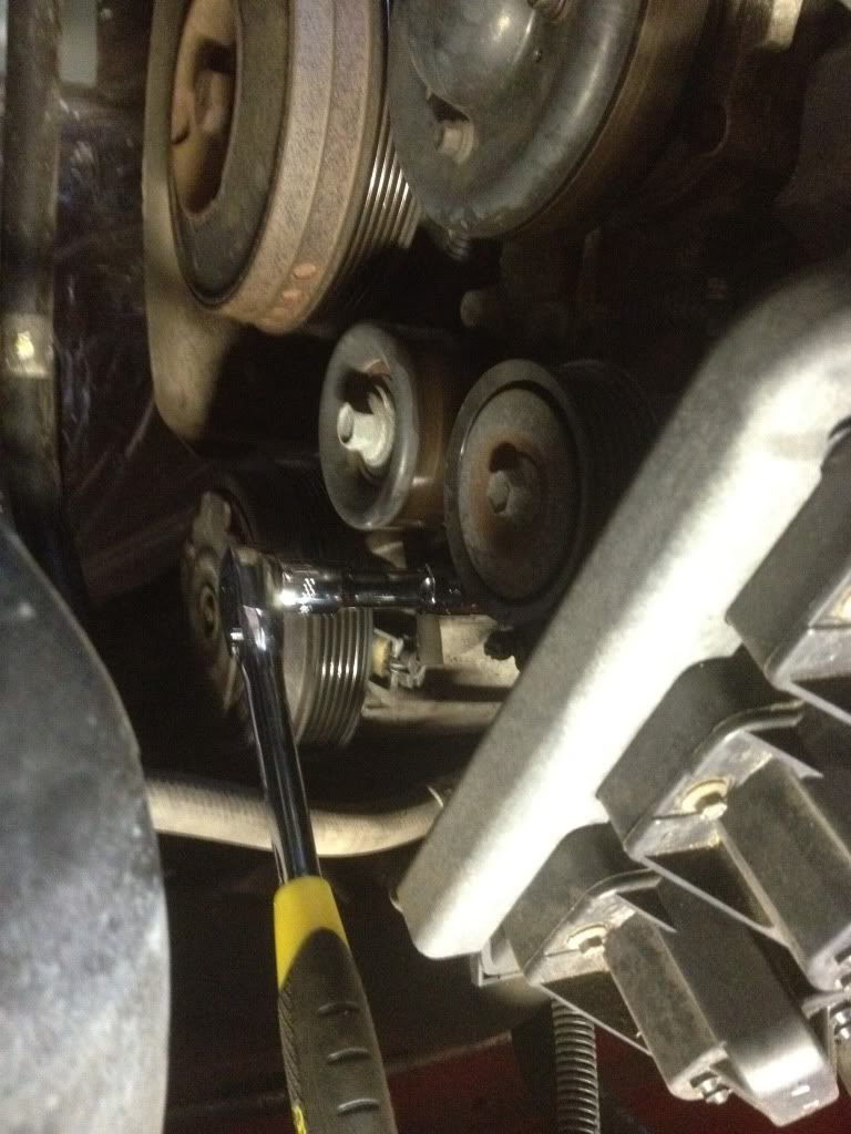

1: Remove serpentine belt (the belt which spins all the pulleys for things like power steering a/c etc)
IMG_05411-1.jpg~original
To do this you will need to put a 15mm socket piece on to the nut of the tensioner pulley and rotate the rachet anti clockwise (left) this will move the entire pulley down towards the ground, relieving the tension. The tensioner pulley is located just below the alternator but slightly to the right. its sort of half hidden behing the radiator hose pictured above!

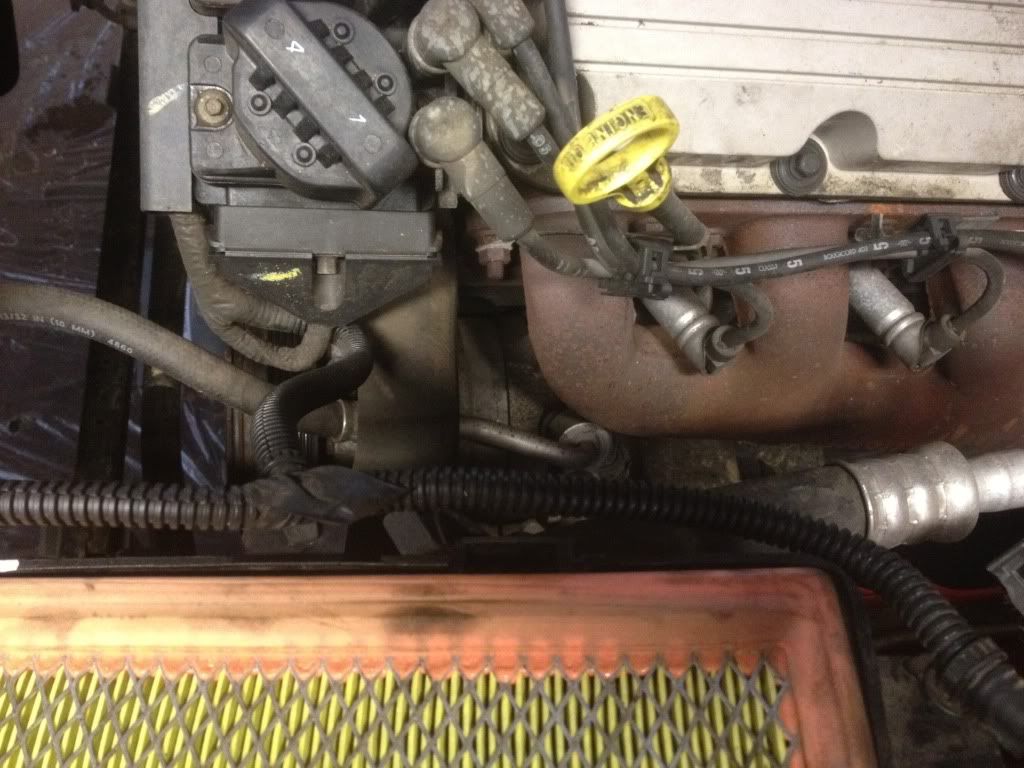

2: Putting asside the A/C compressor (the pulley in the bottom right hand corner, closest to the RHS wheel)
There are 2 nuts and 1 bolt holding the compressor onto the block (DO NOT disconnect the hoses coming off the back / top of the compressor)
IMG_05491.jpg~original
there is one (pictured with the rachet attached to it) and another nut below the small pulley next to compressor. The bolt is located on the side facing the RHS wheel and is located just below the exhaust manifold (the group of 3 exhaust pipes that merge into 1 and head to the back of the engine)

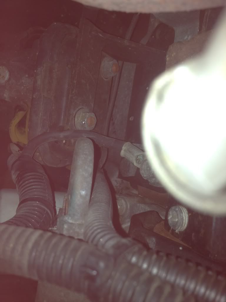

IMG_05471.jpg~original
This one is an absolute C#$T of a thing to get to, i had to mix and match 2 sockets together to find the right extension piece and a small 14mm socket piece.
Now all you have to do is let it sit on the sway bar, pushed towards the radiator (very front of the car)

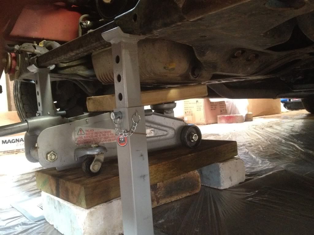

3: place the car on stands at a height easy for access under
4: place the jack underneath the sump with your block of timber (prefferably pine as it is a SOFT timber) and just take the weight of the engine

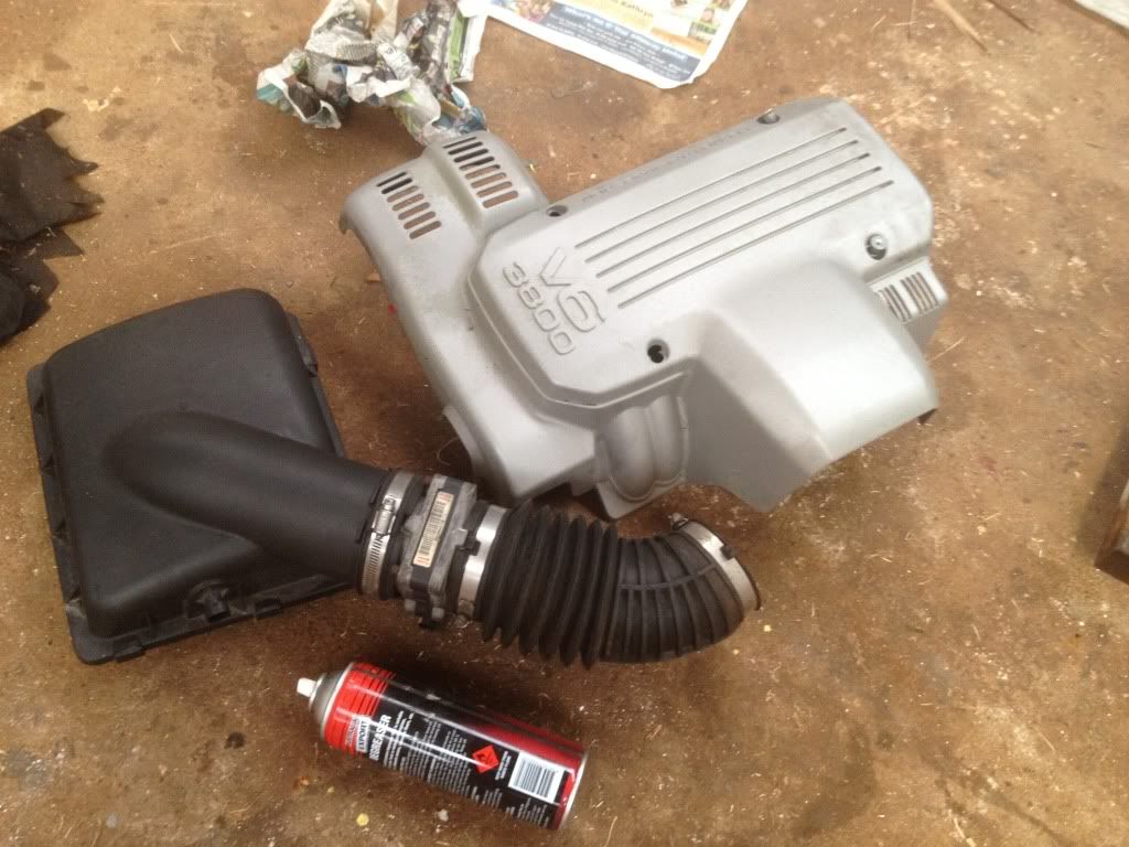

6: now your going to need to remove both the engine cover (4 obvious nuts) and the air box (undo the hose clamp holding the intake pipe to the throttle body)
IMG_05441.jpg~original
