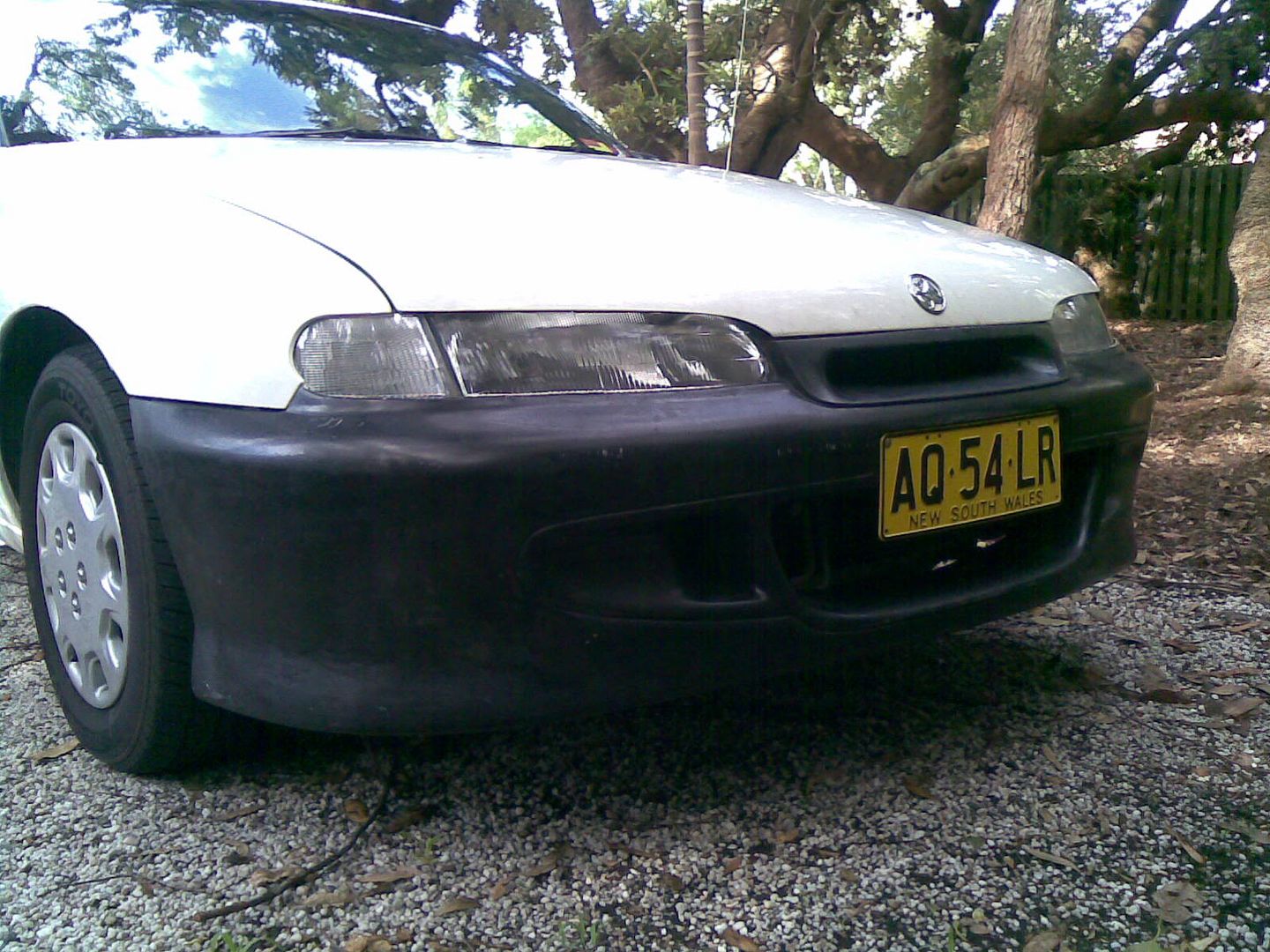

    Heres the beast when i got it

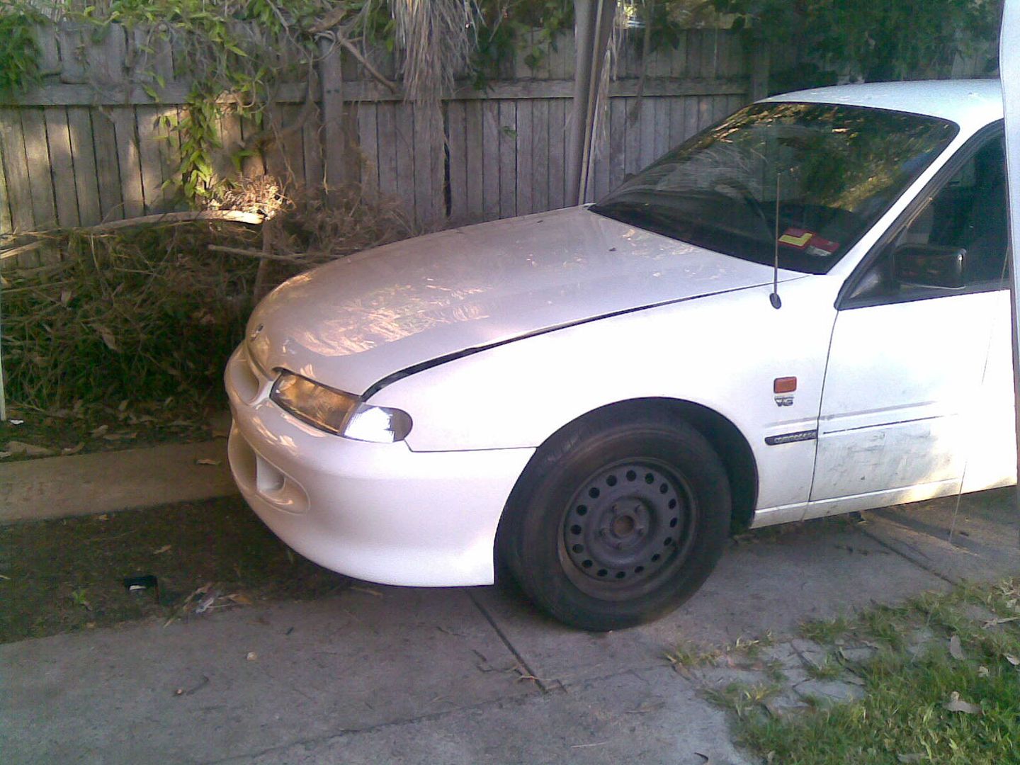

    My Naked car, Replaced my bent gaurd while the front bar was off

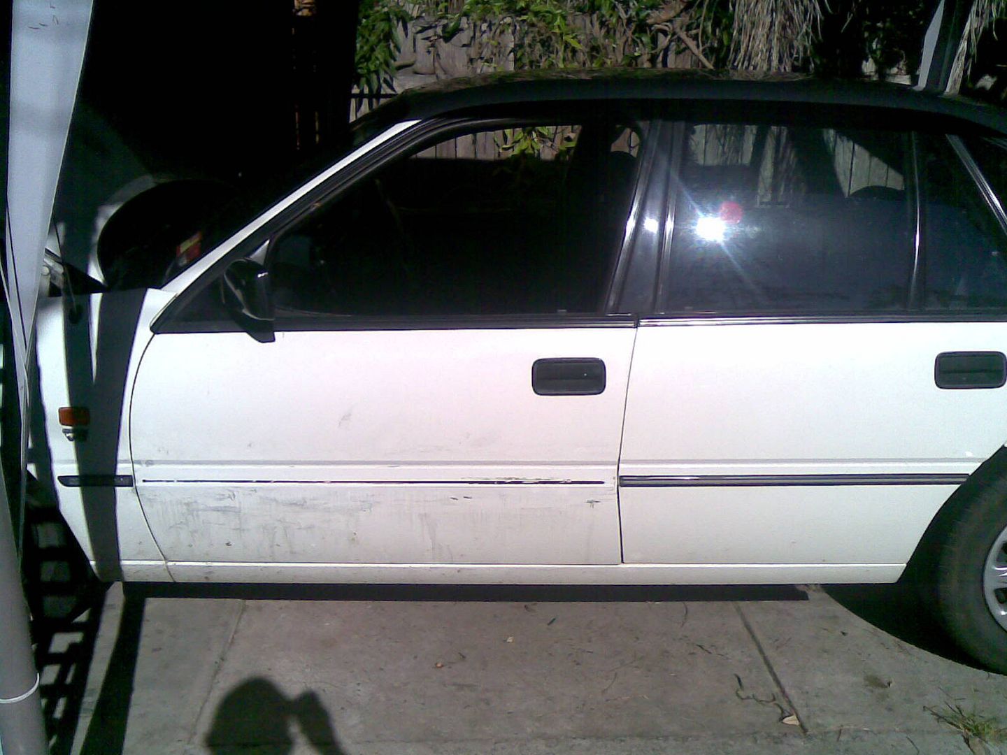

    My **** poor attempt at pulling the strips off, which didnt exactly go to plan

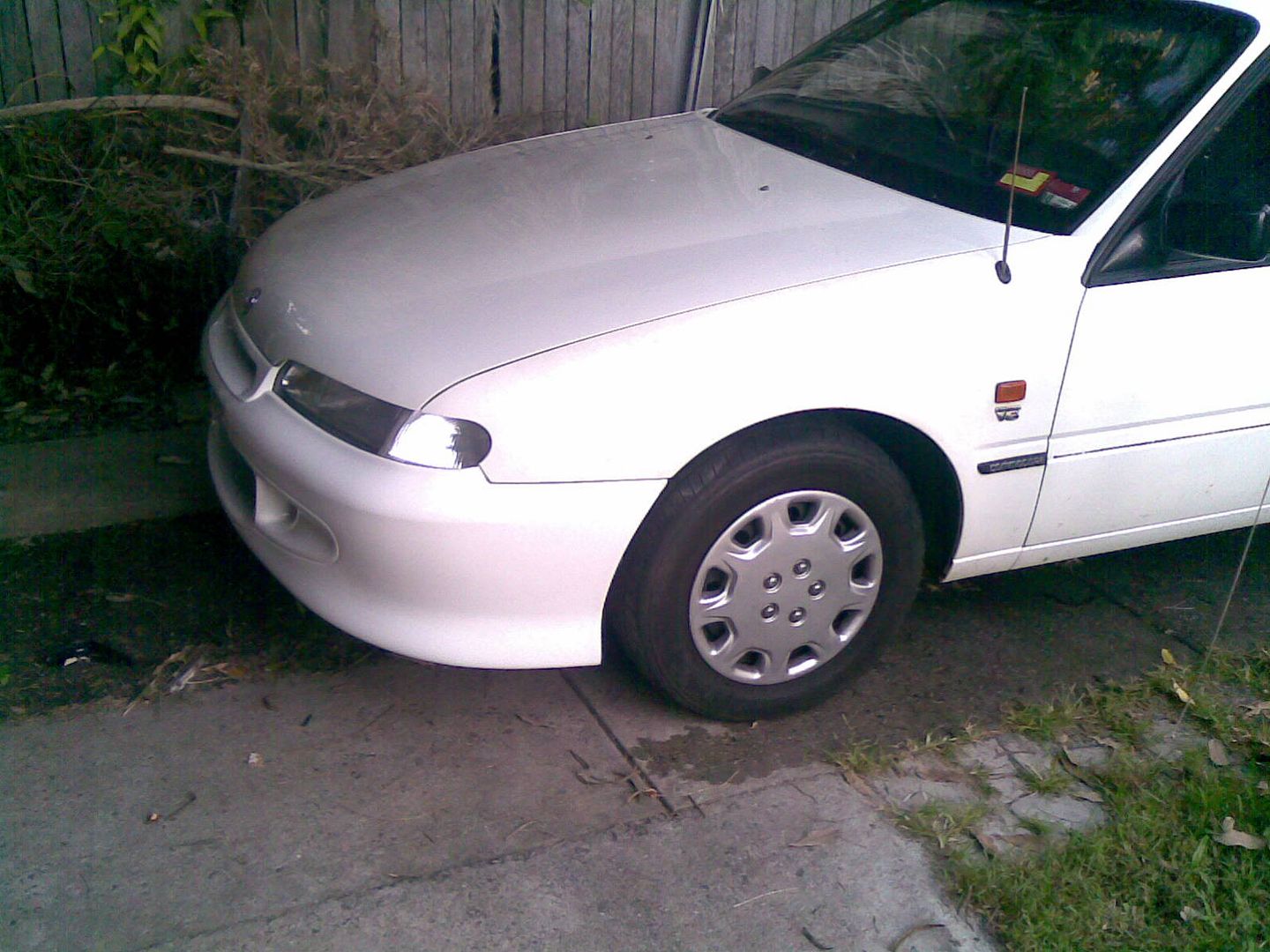

    And the finished bar

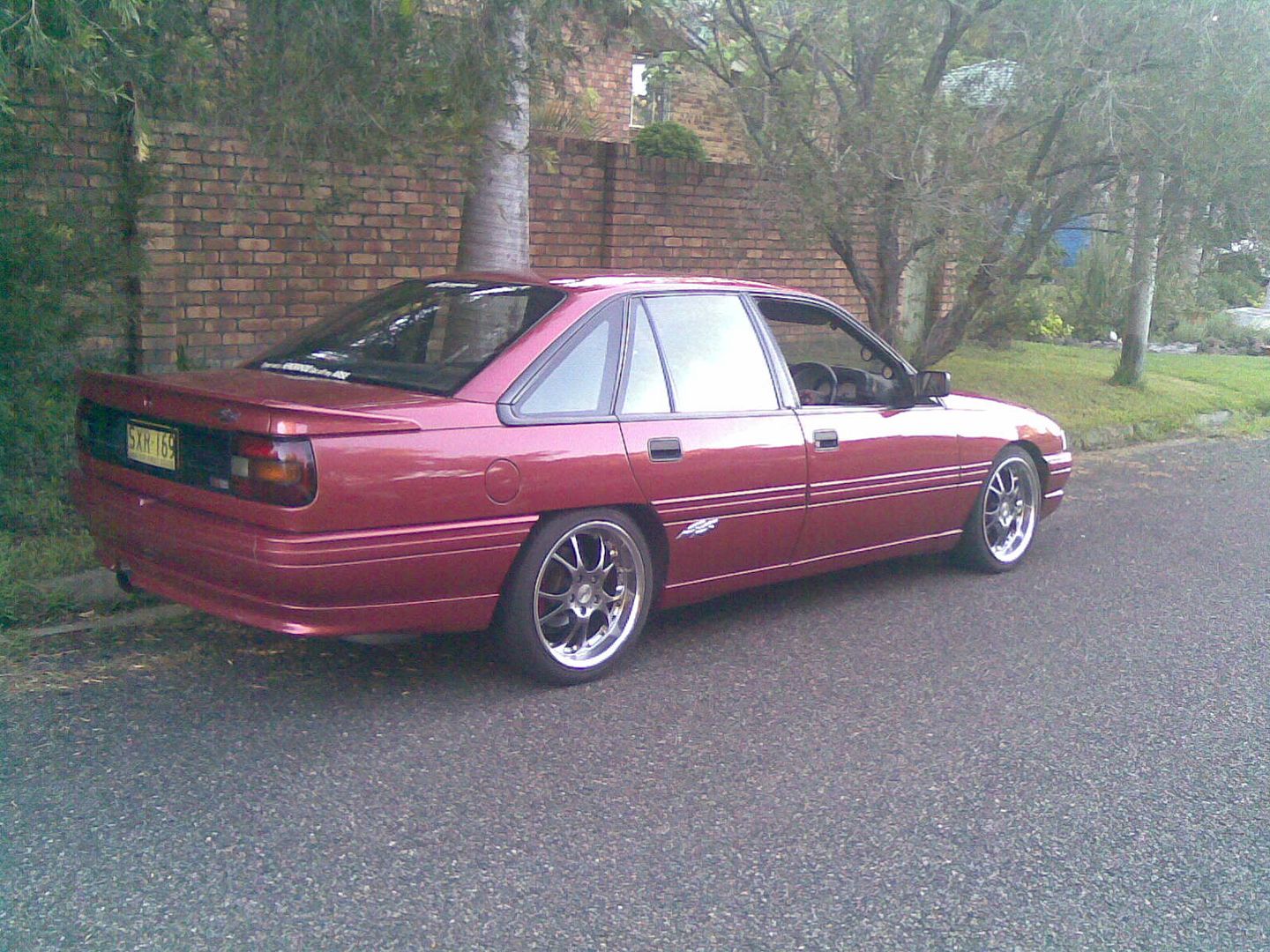

    and just thought id throw in my dads VN SS

    go get some double sided tape and the strips should stick on again good work keep it up

    That clubby front bumper looks sweet..pitty bout the strips oh well sh*t happens ya cars looking good mate:thumbsup:

    im keen to get them strips off, just gotta work out how, the bastards are stuck on damn good. once i get the rest of the clubby kit i think ill just hack int the doors and get the strips off and repaint them.

    p.s your dads ss is foiken sweet dude

    Strips are held on with urethane and double sided tape, the tape is easy to get off but the urethane isn't. What you need if you want to do this without wrecking your paint is a "caramel wheel" or rubber eraser wheel as it's known. You can pick one up from a panel shop supplier,if not sure ask your local panel beaters if they'll sell you one of theirs or ask where to get one, I did and they sent me in the right direction.
    Believe me it's not easy, I've almost given up on getting these damn evil hell strips off, HSV ordered the bodies from Holden without strips.. sure I don't need to explain why :p
    When you remove the strips as well a good thing to use to remove the strips but not the urethane is an old bank card, bow it into a ( shape and also apply hot water and take your time, you could scratch the paint otherwise. And ignore panel shops who say it's impossible to remove the urethane, I've seen many get it done (but only on VS's and newer, which have 2 pack paint, the VR's and older have acrylic paint which literally burns with the caramel wheel)
    Oh, a caramel wheel is a drill bit extension that's like a rubber, you run it over the strips very slowly and firmly, I haven't had much luck with it but I'm sure you will, just read the instructions and take your time.

    ill look into that caramel wheel thingy, at this point ill try anything cause i want them strips gone!

    Thats the attitude mate! Good on ya, Yeah you done a top job on painting that front bar. Yah, defiantly look into the caramel wheel, either that or paint the bumpers white. Its good to have them white if you take it to the shops allot because we all know they can save a ding or two!

    getting them strips off is a pain in the ass, i dunno where to get one of them caramel wheels from.
