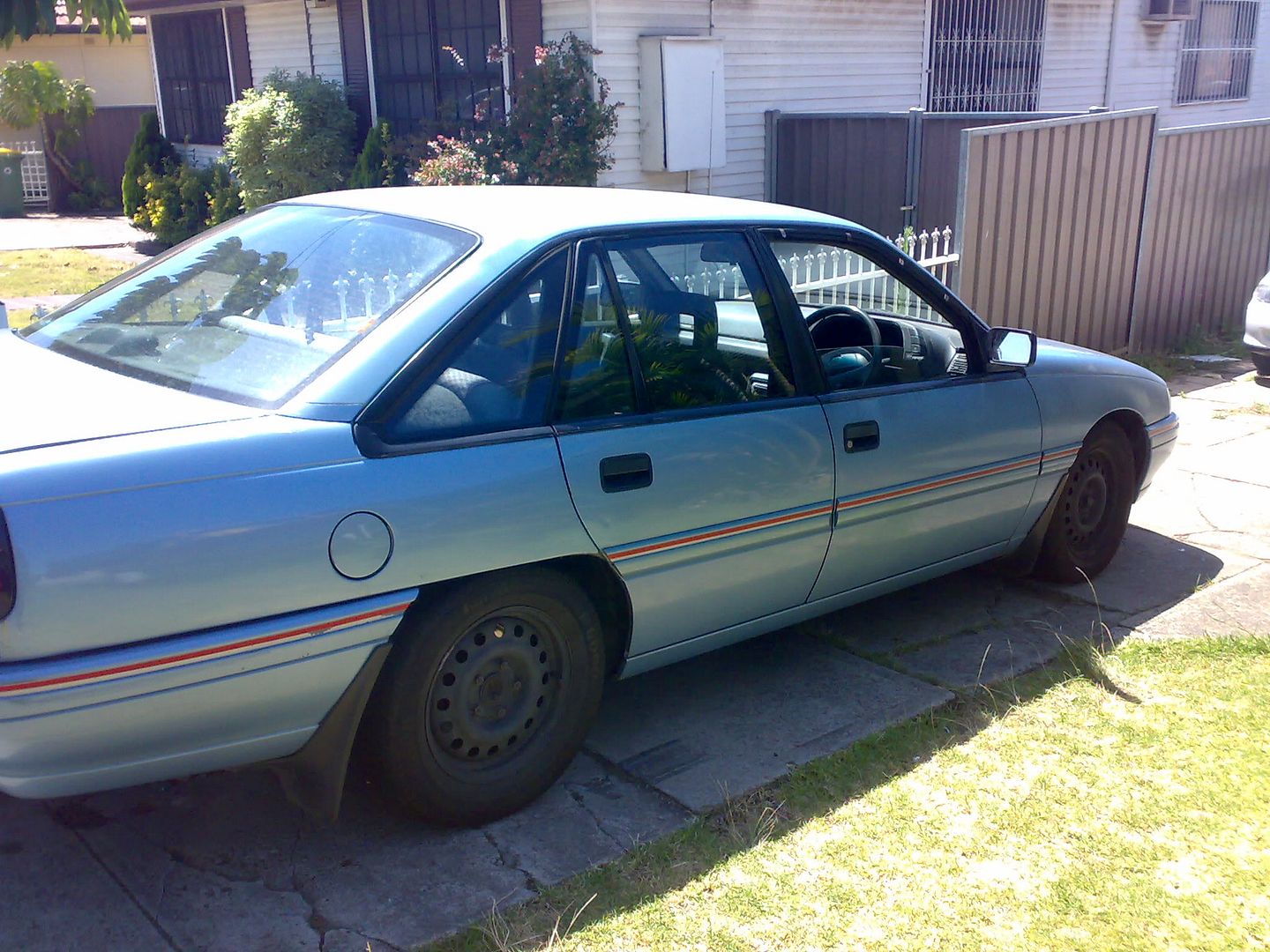

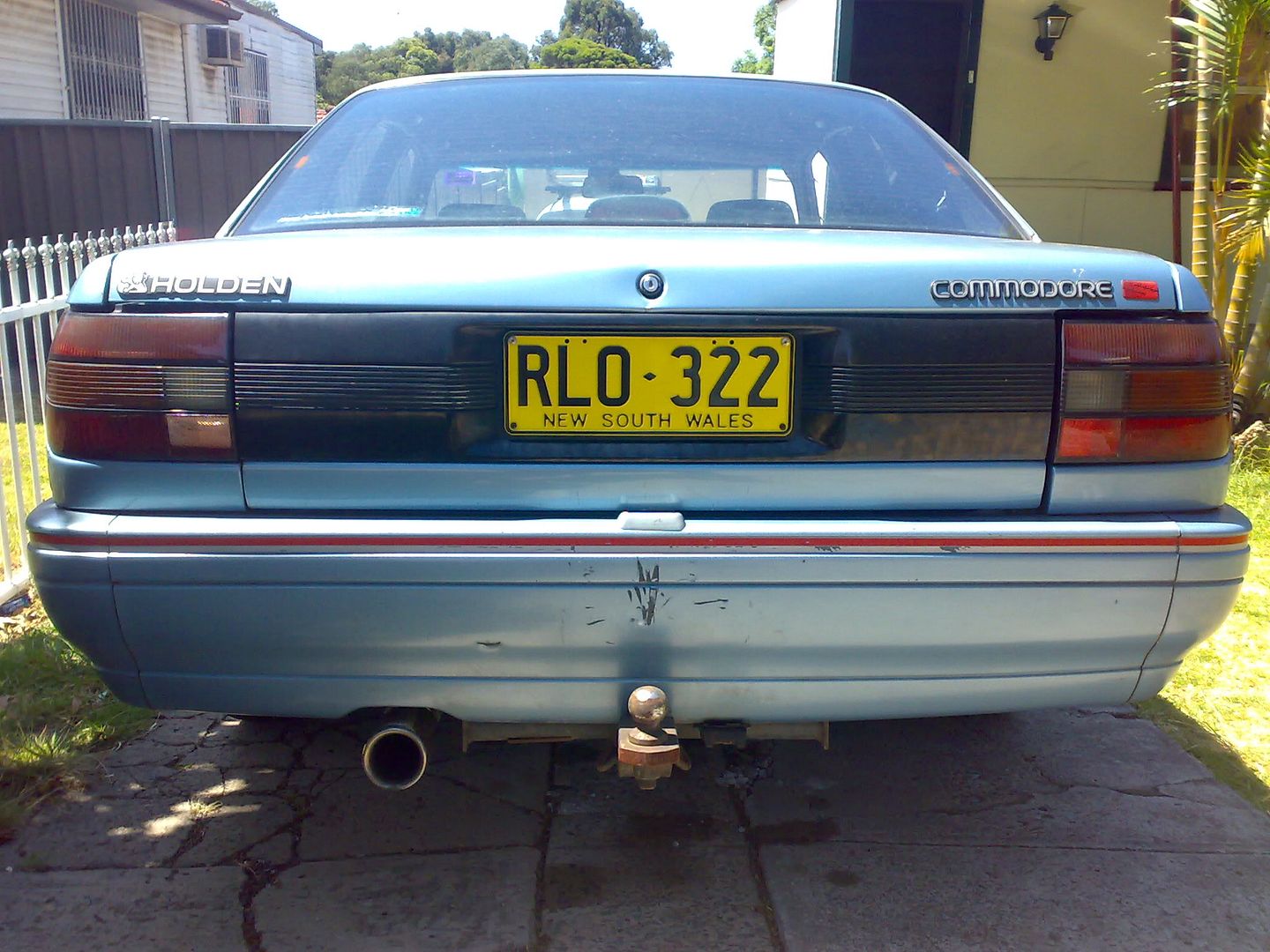

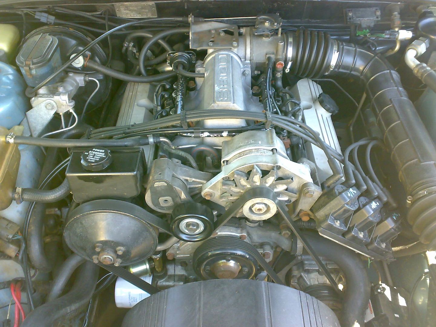

    Here we go, my ride;
    1989 VN V6 S1 S-Pac.
    5 Speed Manual.

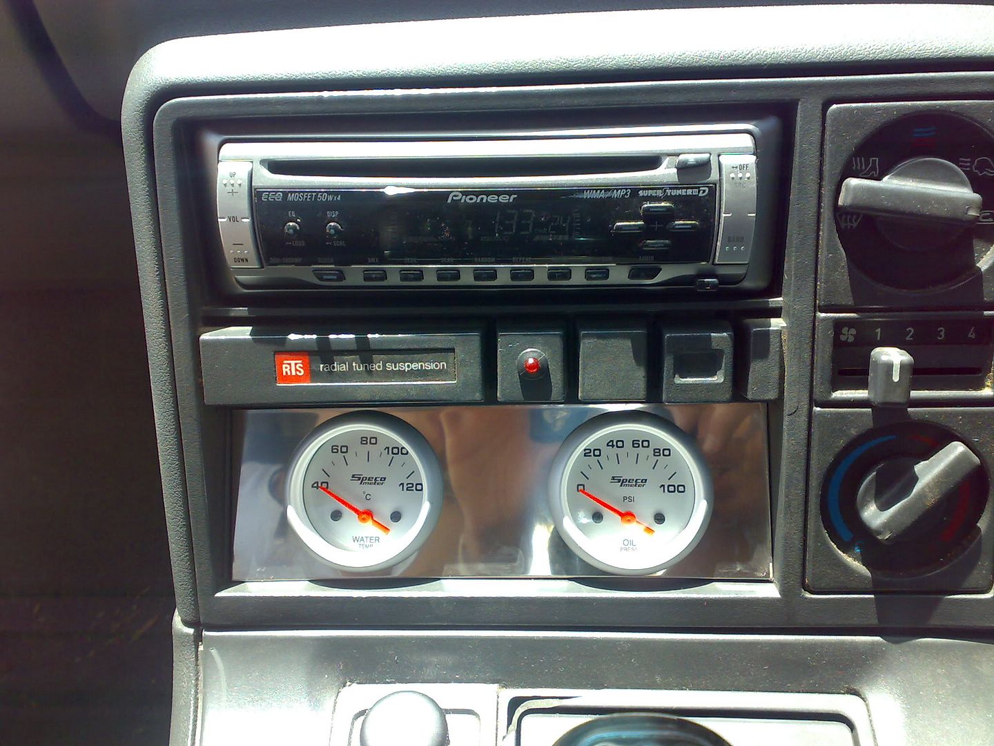

    Performance Mods:
    Greenfoam Memcal Tune
    Pacemaker Extractors. High flow Stainless Cat. 2.5" Sports Exhaust
    Other Mods:
    Pioneer Head-unit
    Gauges
    Future Performance Mods:
    YT 1.8:1 Roller Rockers
    Cold Air Intake
    Minispool with 3.7:1 Diff gears
    Strut Brace
    Future Other Mods:
    Complete Stereo Overhaul, excluding head-unit.
    Sports Wheels
    Sports Pedals
    Spotlights

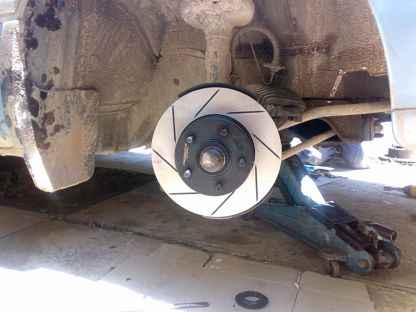

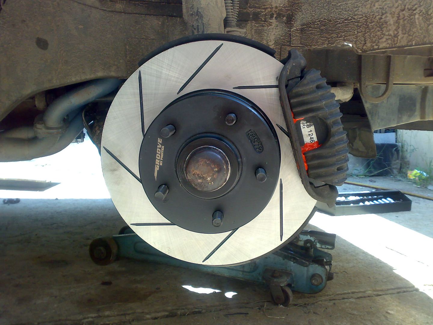

    New Rotors
    http://i202.photobucket.com/albums/aa79/crazy_biker/23022009187.jpg
    http://i202.photobucket.com/albums/aa79/crazy_biker/23022009188.jpg

    STEALTHY suggested I write up a tutorial on how I did my gauges, but honestly, I can't be bothered, plus don't have pictures for step-by-step instructions. SO, if anyone is interested and wants to set up something similar, just PM me, and I'll reply, eventually :p

    Finally got around to it.
    New Slotted rotors with QFM-HPX pads.
    Looks meaner now :yeah:
    The car definitely pulls up better now. Glad I finally did it.
    QFM are definitely gonna be my regular brake pads now.

  10. crazybiker
    crazybiker Member
    703
    Sep 9, 2008
    Sydney NSW
    VR Commodore V6
    Thanks. It is quite nice, sadly needs a good paint job though (Will happen eventually).
    Brakes? Nah mate, just a VN V8 rotor that's slotted. Not a different model at all. Still got the original single piston caliper (That's what's gonna get changed next).
    It pulls up quite a bit better than before, not sure whether that's the pads though. I changed to QFM-HPX pads this time, and they're awesome.
    Dad reckons that there's not as much brake fade aswell, so I'm happy.
  11. Leebo
    Leebo New Member
    241
    Feb 12, 2009
    89 VN
    Yeah that's what i was thinking of getting the standard 270mm slotted will go straight on but you have the slotted 290 did it go straight on after you knocked the old one off?
    Standard caliper really mine look nothing like that and you appear as is you have braided lines is that right?
  12. crazybiker
    crazybiker Member
    703
    Sep 9, 2008
    Sydney NSW
    VR Commodore V6
    Braided lines? Not sure.
    As for the different caliper and the 290MM discs.
    They come standard with the 'S' Series, but yes, they bolt straight on, no dramas.

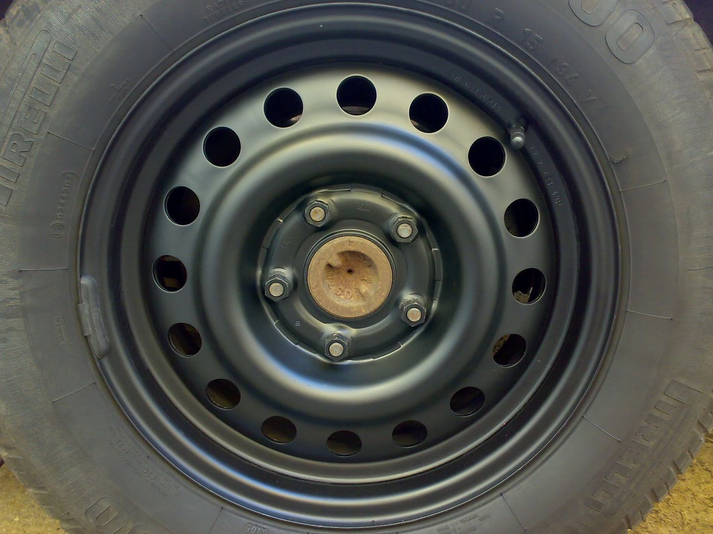

  20. crazybiker
    crazybiker Member
    703
    Sep 9, 2008
    Sydney NSW
    VR Commodore V6
    Well, I've been meaning to take the wheels off and paint them matt black. I did that today. Finally.
    Pain in the ass actually. Degrease them. Sand them down. Wash them off. Clean with Acetone. Paint...x4.
    But it was worth it. Came out pretty good.
    Thumbnail has the reduced image.
    For the full size image, it's in the first post.
