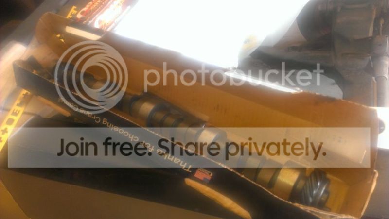

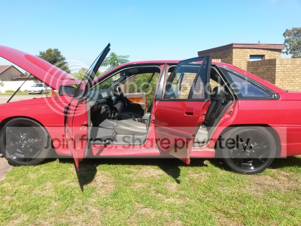

    still not in the shop but I got a few things...
    Mechanic hasnt found me a new motor yet so still waiting to book it in. But that hasnt stopped me picking up some new bits for it. Firstly is a brand new crane 286 cam and lifters to match. Scored it for a great deal. I have some questions however. Can i run that in my car with no other mods/parts required? Also are they easy enough to install yourself if you are mechanically minded?
    Next little treat is i am ditching the sv 5000 kit in favour of the rest of the genuine aero kit that i managed to talk my brother in law into selling to me.
    Will post pics as soon as i can

    A 286 NEEDS higher compression, so the heads will have to be skimmed and (ideally) ported (and at the same time new valve springs)....you will also need a tune so there goes another $550 minimum (a good dyno tune will be around $800), the car needs to be tuned for the cam, it will not run on the factory tune with a cam as aggressive as a 286 (Don't waste your money on a MACE memcal or ebay memcal as they are still for stock engines not high compression cammed motors)
    It's not a job for a beginner and you need to buy tools to dial them in. (and the head work will have to be done by a machinist/engine builder)
    A 286 will also be a little doughy on an auto so good idea to get 3.45 ratio or better gears for the rear end.

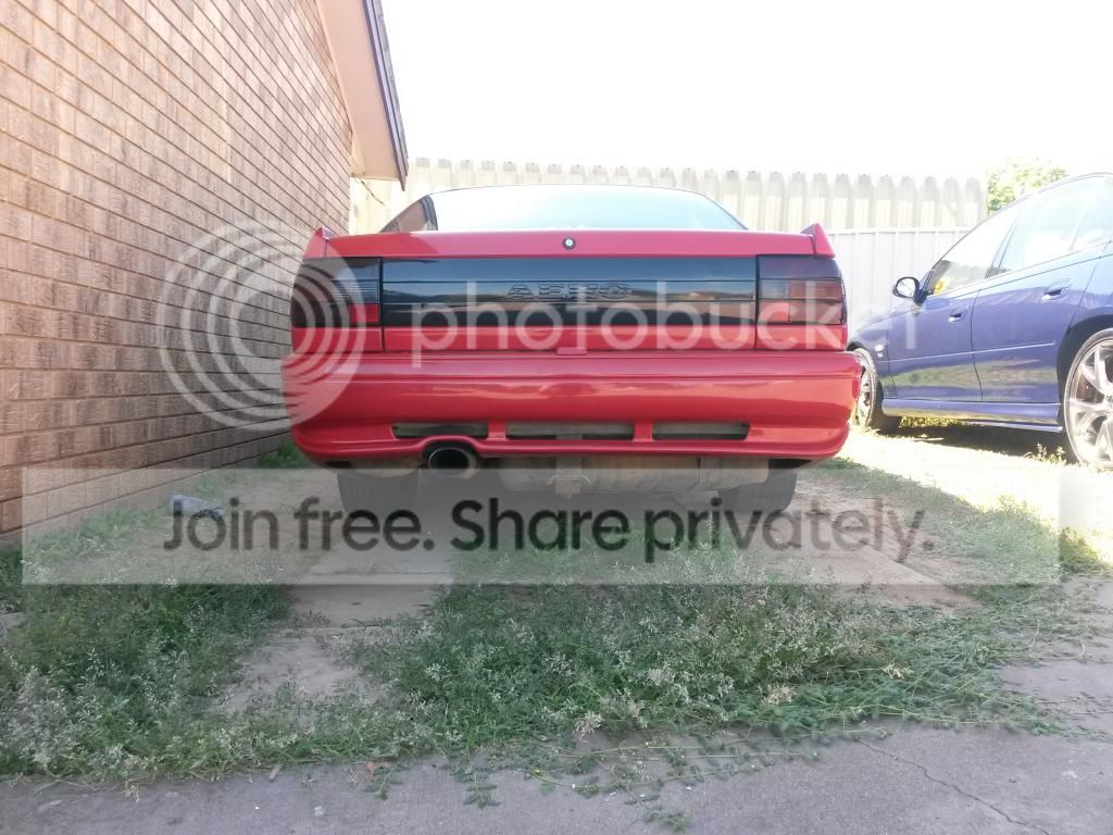

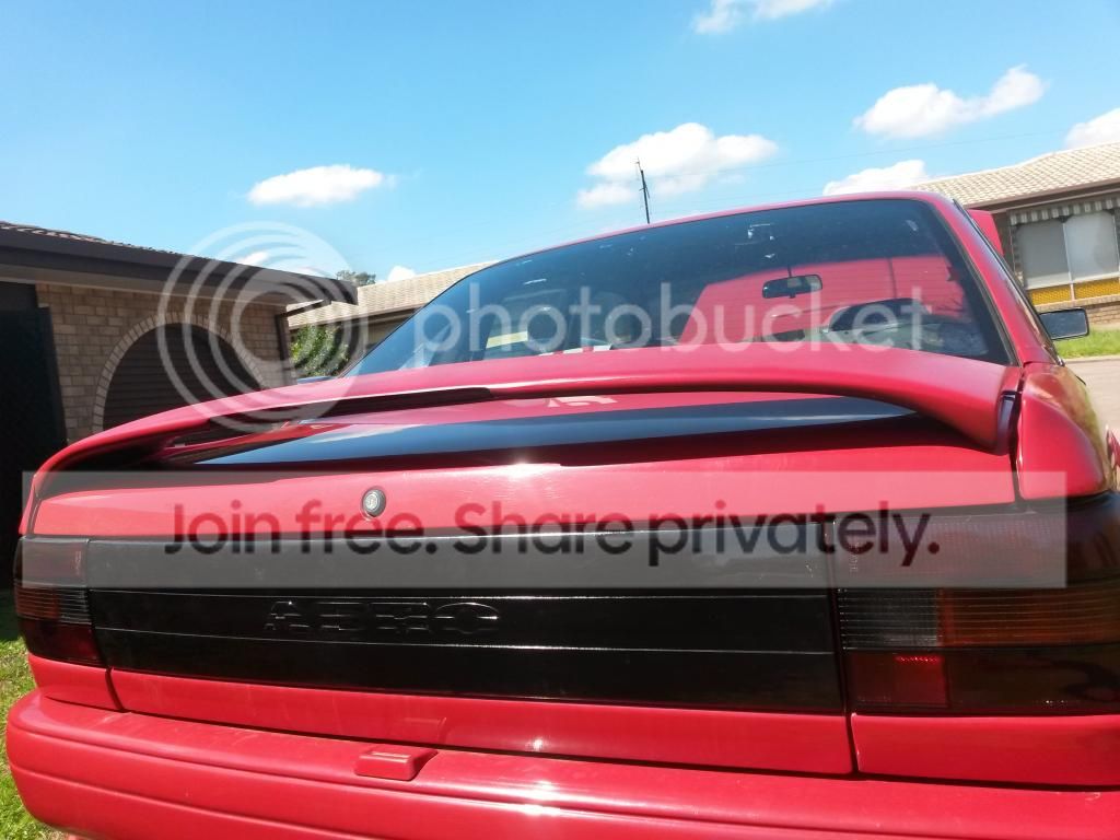

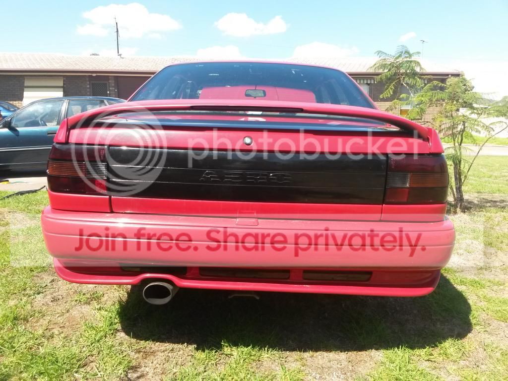

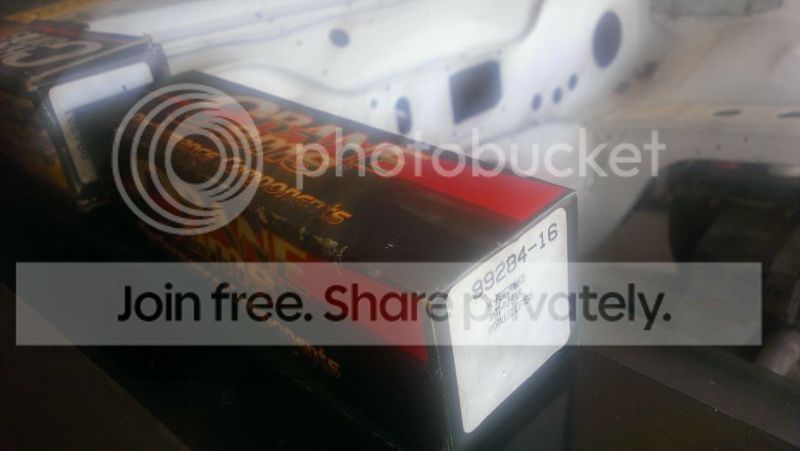

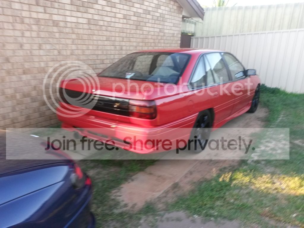

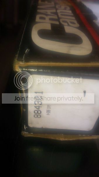

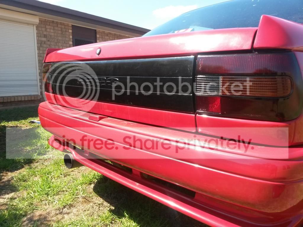

    Well, the Vn is still sitting at my house. Havent been able to find a new engine for it so i might just get the bottom end rebuilt on this one. This hasn't stopped me getting some more goodies for it.
    I have put a deposit down for the Crane 286 cam and lifters and will be picking it up on the 8th of April. I have been told that to increase the compression ratio, i can bolt on a set of VT 5L heads, so i think i will do that. Still unsure of where to go for the tune though.
    Also my HDT Aero kit is now at my house and ready for final sand and primer, then paint. I have taken a couple quick pics while test fitting the garnish and spoiler just to see how its going to look (i couldnt help myself)
    The rest of the kit wont go on the car until i have painted it so no photos of the kit for now.
    Finally, i have a video of me starting the car after sitting for a few weeks. Still sounds fairly nice but blowing a fair bit of black smoke which leads me to belive that the rings are gone possibly or maybe something more sinister. If anyone can shed any light on this and steer me in the right direction as to what i need to bring this engine back to life, that would be highly appreciated.
    Any way, without further adieu, here are some pics!
    Cam and Lifters:
    Aero Garnish pics:
    And..The video:

    Cheaper to just get your heads skimmed etc than buying new heads (unless you can get them dirt cheap, and if u can then there is probably something wrong with them)
    Remember the VT's are a roller motor, so as far as I know you would need a roller cam and roller lifter not the standard flat tappet lifters and cam setup.
    It doesn't cost much to get headwork done to yours so just go that way (a good set of VT heads will probably be $4-500)
