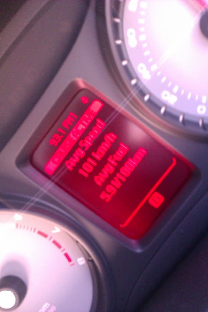

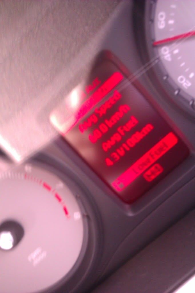

    Sorry for the poor quality.. 4.3L
    and on highway
    5.9L @ 101km/h
    Tuned by Mace. Automatic

    Hey Atomic,
    What engine/gearbox you running mate?
  13. Atomic G
    Atomic G New Member
    87
    Jul 24, 2011
    Wagga
    VE Ute
    2010 Ve SIDI ute(LLT), Auto.

    What kind of driving were you doing to get 4.3L/100km? Short of driving down a hill the whole way...
  17. Atomic G
    Atomic G New Member
    87
    Jul 24, 2011
    Wagga
    VE Ute
    No straight flat road. Just had it in semi-auto mode.
  18. MikeCuzzy
    MikeCuzzy Jumping puddles
    1,355
    Jan 29, 2010
    Australia
    2007 VE Omega 3.6L
    That's crazy good mate, shows what these cars can do.

    Yes but over what distance, is that the average you get out of every tank, or was that reset and taken at the end of the street?
    To measure your average over 100kms, you need to actually drive the 100kms, not take a photo after 1km and call that good economy.
