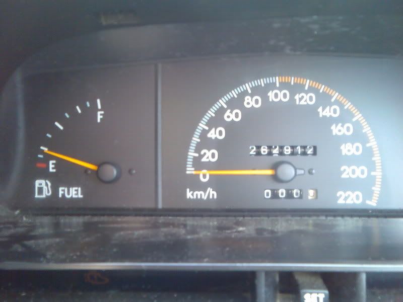

    Hey guys i just put $20 petrol in got round 18L and i noticed the fuel guage barely moved, now when i first got the car it used to go almost half wayish on $20, also the fuel guage has become very sticky over the period of time ive had it, now i have to hit/tap the cluster screen for it to move?? Just wondering if u guys think that the guage is correct for around $20 petty.

    common problem with commodores, there will be a dry solder joint on the back of the dash cluster for the fuel gauge. this is very common. my VN has it, the missus VS also. my VN shows it's empty when there is still 15-20lts left and i gotta give the holden handshake (tap the dash) sometimes to get tthe guage to read anything

    lol i actually give it quite a bashing, but still it barelly moves, i dont wanna drive round scared thinking im running outa petrol and have no cash till pay day haha "holden handshake" haha love that :)

    yeah, i fair bash mine sometimes to get it to read something. i get around the fuel runnign out problem by the fact that if i fill it up and do a lot of open road/highway traveling i get about 480-500km from a tank of gas, if it's only stop/start, short trips etc i fill it up before 400km etc

    so how do i go about fixing this, im planning on getting a level 3 cluster later on any way, but is there a way i can fix this little problem for the time being.

    you'll need to pull the cluster out and resolder the dry joint. ifyour goingto change to a level3 cluster maybe just put up with it for now etc
