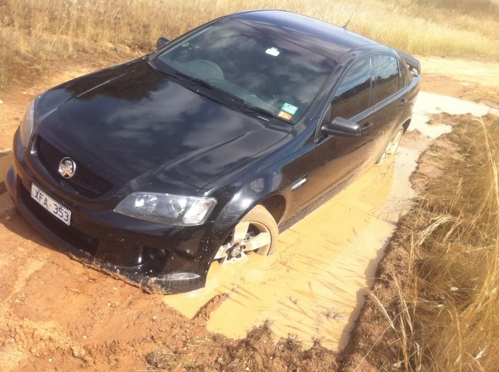

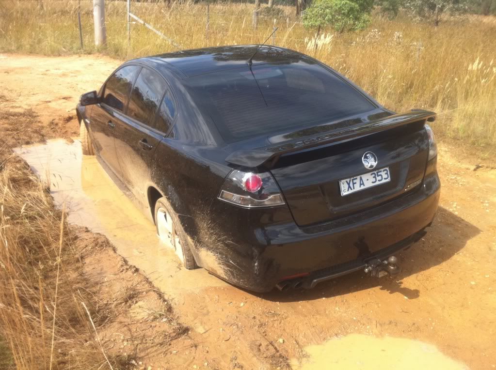

    So a few weeks ago i got the VE bogged in a very slushy grassy paddock. Didn't realise it more closely resembled a rice paddy underfoot than your average paddock until i was half way through a U turn, when the traction control started to kick in and the car pretty much sank about 2 inches.
    What can one do to get themselves unbogged from a situation like this ? Luckily a mate was close by with a Patrol equiped with a nice Winch so it was all resolved without too much trouble. If he hadn't been there what could i have done ? Someone jokingly suggested snow chains. That's about the best thing i can think of, besides carrying a snatchem strap in the boot to hook onto someone elses towbar, or just staying on the road perhaps LOL.
    Would an LSD have helped ?

    An LSD would have helped. You could drive both wheels rather than just the one without traction.
    In future if you turn tc off and pull the handbrake on you can apply force to both wheels and get them both to drive helping you get yourself unstuck.

    Small amount of gas and pull it up slowly til the one stops spinning. It'll work if your a little stuck and digging yourself a hole.
    The open diff lights one up because the torque required to drive that wheel is near zero. By applying a torque to that wheel you can end up having the torque to drive the two rear wheels not differing by as much (percentage) so it'll drive both wheels.

    DO NOT snatch off a towball unless you want a chrome missile should something break.

    Hmmm, nobody wants any missiles during a recovery, but at least the tow ball is designed to take a horizontal load. That brings me to the next issue we had - trying to find somewhere strong enough on the front of a VE to winch on - given that the tow point, aka 'tiny little slot' on each side of the VE was far too small for the winch hook on the Patrol to fit into. Was not happy !! It was a tricky puzzle to solve at 12.30am in a dark paddock.

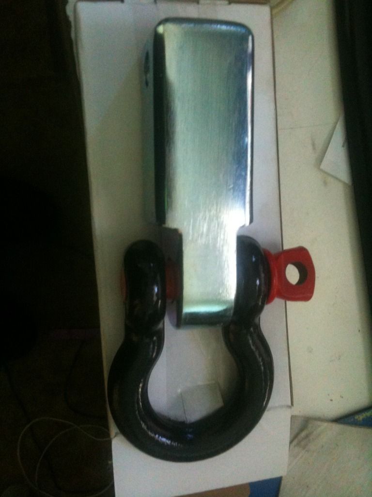

    Agreed. You shouldnt be snatching off anything less than a rated recovery point. You can buy these:
    Which go in your towbar hitch. They're rated to 4.7T and cost $26.
    Tigerz11 - HITCH RECIEVER & 4.7 BOW SHACKLE
