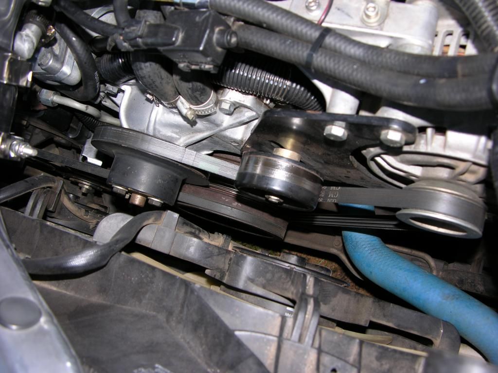

    Hi All!
    I have a 97 VT SS and after a bit of machining and adjustment I have had a set of gilmer pulleys fitted..They sound great and look the part...I have however discovered a minor problem!! The pulleys we have here in NZ are for a 308...ya can get em ta fit but the alternator pulley is a larger diameter than a 304's...So the issue is I am not getting a charge at Idle..Does anyone know of anybody doing correct sized alternator gilmer pulley's for 304's in Aus or NZ??? Or am I going to have ta get one manufactured?? I dont want replace the alternator as I just had it rebuilt!
    Any help would be appreciated!

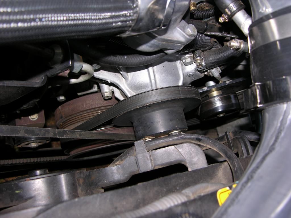

    some pics....sorry bout the dirt....

    I disagree Wraith, Gilmer kit's have their place. V belts are rather out dates and in-efficient when compared to modern micro-V serpentine type drives which fortunately his VT should have. At least with a gilmer belt you have positive drive and your not relying on high friction and the belt been wedged into the pulley to create drive.
    Unfortunately with most Gilmer kits on the market low alternator rpm at idle leading to poor charging is normal due to the change in pulley sizes. You can't really make the alternator pulley any smaller otherwise you wouldn't get the nut on the shaft after fitting the pulley, however they have reduced the diameter of the crank pulley and the water pump pulley which creates this issue.
    The best kit on the market is from Die Crest but you will have charging issues with a standard idle rpm
    diecrest | eBay
    But they don't have a specific kit for a VT (which is slightly different to VN-VS).
