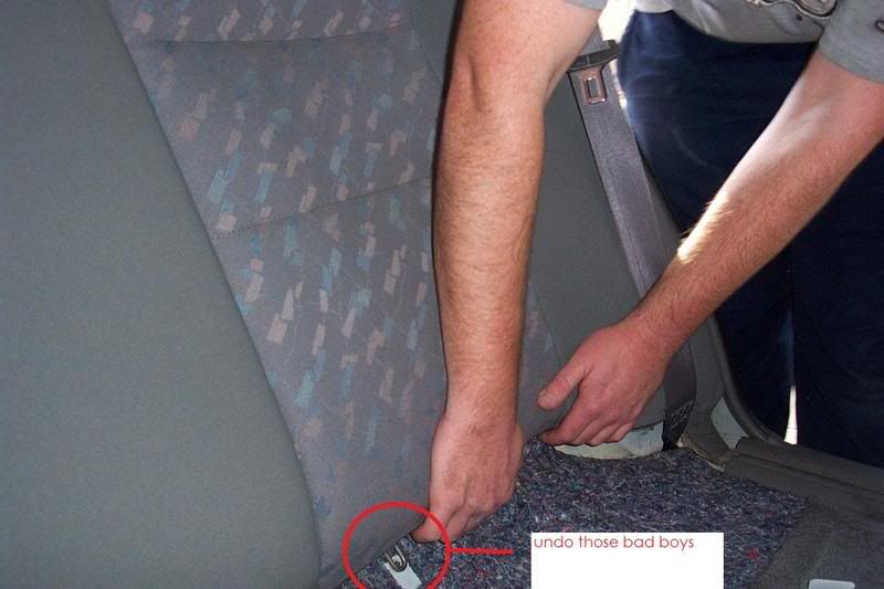

    i have worked out how to remove the horizontal part of the rear seat, but how the **** do you get the vertical part off (i need to put seat covers on)
    the manual only had instructions for a wagon, i have a sedan.

    the back rest are in two pieces so there should be a bolt holding each backrest on. (look at the picture) they should be there so grab ya 10ml socket and take those off. once off pull upwards on the back rest and it should jimmy out if its the first time they've been off it might be a bugger of a thing to get off :D

    hey thanks heaps for your help!!!
