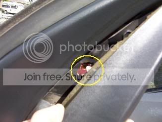

    Step 2.
    Grab your precision screwdriver and unclip the door lock like so...
    It will then be able to pull out easily.

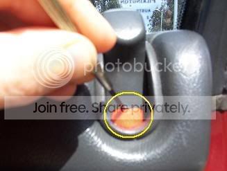

    Step 3.
    You will notice the screw is highlighted below. Undo it using your philips screwdriver.
    The lock casing should easily lift out like so....

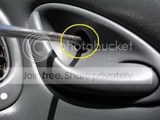

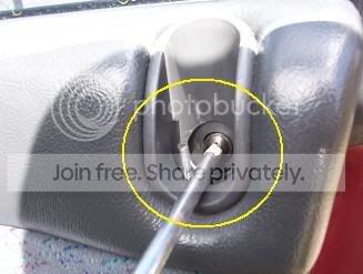

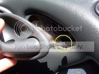

    Step 4.

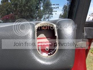

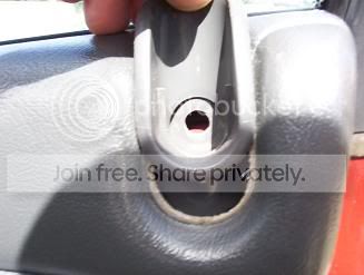

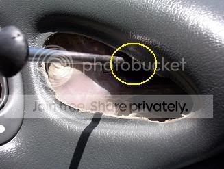

    Grab your precision screwdriver again, and unclip the plug inside the door handle as seen below.
    You will then notice the screw behind the plug.
    Using your philips head screwdriver, unscrew the door handle.
    As you pull the door handle you will notice that it is attached to a metal rod. A gentle twist will un-snag it.
    Where the door handle was, You will see a screw behind it.
    Unscrew it using your philips screwdriver.

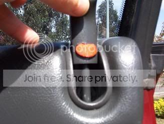

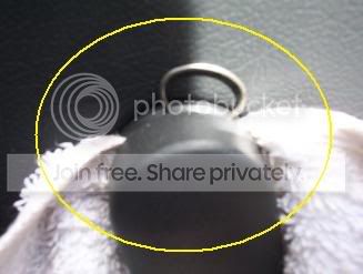

    Step 5.

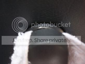

    Time to remove the window winder.
    Grab your rag or cloth and slide it behind the winder like so...
    Move the cloth side to side to get a grip of the pin behind the handle.
    The clip will pop out like so..... And you can then pull on the winder to remove it.

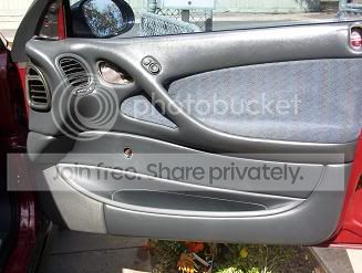

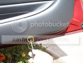

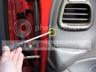

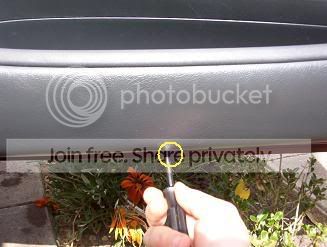

    Step 6.

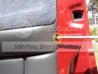

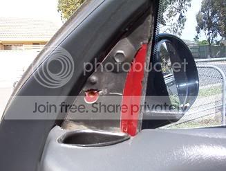

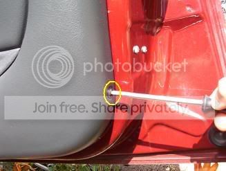

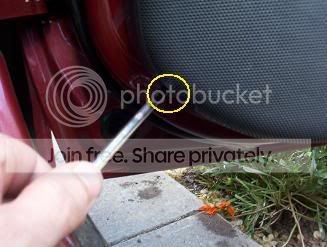

    Now its time to un-screw the outer screws on the door card. The detailed pics below highlight the screws where necessary.
    [​IMG][​IMG]
    [​IMG][​IMG]
    [​IMG][​IMG]

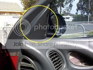

    Step 7.
    Now we need to remove the vent cover as pictured below.
    A slight pull from the back outward will un-clip it.
    _____________________________________________________________

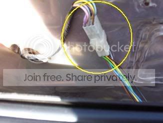

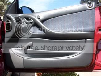

    Step 8.
    Pull the bottom of the door card out (all the way round) and then slide it up until its free.
    Before you can totaly remove the card, you will need to unclip the mirror switch.
    [​IMG][​IMG]

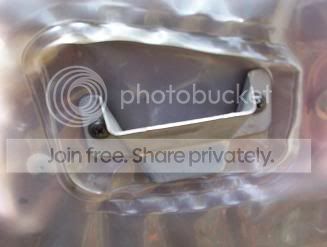

    Ok so now the door cards off. Remember this bracket as pictured below because you will need to match it up with the door card clip when re-installing.

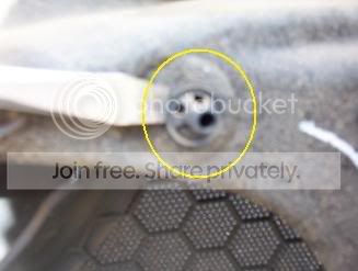

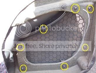

    Step 9. - Removing the Speaker Grill.
    On the back of the door card, you will notice a few clips and a screw as highlighted below.
    Grab your flat screwdriver and pry the clips off carefully.
    You will end up with 6 clips and a screw at the end (Back doors have no screws) The grill will then slide out.

    Nice write up Ozzie . Just like to add one thing, when puting it all back together. Make sure that you clip the door trim up under this bracket first before fitting trim to the top of the door .If you don't do this you can end up with a window that rattles when fully wound up .

    LOL thanks Dayvo. I added the bracket pic to give that impression but I missed that part:p

    That trick with the cloth to remove the Jesus clip is effing brilliant!

    Cheers but i cant take the credit for it. I got it off this forum from another member (cant remember who used it) who probebly had the idea passed to him ect...
    Definetly effective though.

    Is there a trick to those little metal clips for the grill? i really had to work them to get them off and now they wont go on. Any ideas?
  18. SS245
    SS245 New Member
    Dec 21, 2009
    VZ SS
    I just answered my own question. If you use a pair of side cutter and snip the clip just in one spot it lets it expand just enough as you push it down it fits nice and snug. It holds it pretty tight as well.

    ok well i went and put a tool to remove them for 10 bucks so meh all done GREAT how to thread very detailed.
    Ill add something ozzie didnt in the rear door grille there is 7 clips not 6 and no screw.
