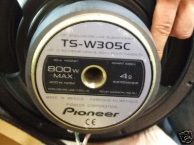

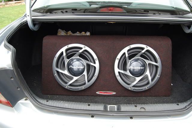

    Basically i have 2 types of subs.
    number one is;
    Number two is;

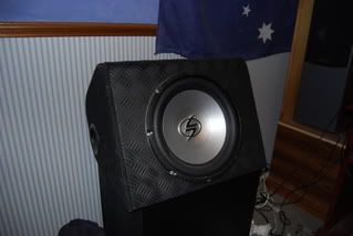

    1000W lightning audio ported sub box

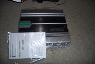

    The amp is a brand new pioneer 800W mono block;
    In my VT what set up will be better. im pretty much jst after a decent stereo that i can turn up and party 2 :w00t:so if anyone has an suggestion or has these subs please post.

    yes the pioneers are sealed, this is wot it says on the back of each pioneer sub;

    ok so the pioneers are 400wrms @ 4ohm each. if the amp can put out 800wrms @ 2ohm then they would suit the amp nicely.

    SpecificationsDescription Value Size12"Impedance4-OhmsPower Handling150 Watts RMS
    750 Watts Max.Motor Size40 oz. magnetVoice Coil2"Speaker ConnectorSpade terminalMounting Depth4-15/16"Recommended Sealed Enclosure1.25 cu.ft.
    (35.4 liters)Recommended Vented EnclosureN/ATuning Frequency (vented)N/AShipping WeightN/A
    these are the spec on the lighning audio sub

    where did you get 1000w from? its only 750w max but doesnt really mean much anyway.

    Maximum Power Output Maximum power output (EIAJ) @ 14.4V[​IMG] 500 Watts x 1(4ohms)or 800 Watts x 1 (2ohms)[​IMG] Continuous Power Output - Watts RMS @14.4V 20~240Hz into 4 ohms 250WRMS x 1 (0.5%)[​IMG] @14.4V 20~240Hz into 2 ohms 360W x 1 (0.8%)[​IMG] Specifications and Features RCA and Speaker Level Input[​IMG] Bass Boost : 50 Hz, 0/+6/+12dB[​IMG] LPF (Low Pass Filter) : 40~240Hz, -12dB/oct.[​IMG] Load Impedance : 2 ohms ~ 8 ohms[​IMG] Amplifier Fuse Rating : 30 Amps x 2
    amp specs

    the pioneer subs would get 360wrms @ 2 ohm. the subs are rated at 400wrms EACH so it would be greatly underpowered.
    the option audio sub would get a maximum of 250wrms @ 4ohm. the sub is rated at 150wrms.
    its always better to overpower then underpower. I would go the option audio sub if you dont want to buy another amp.

    Definitely go the Pioneers, much better branded sub than the Lightning Audio's even if they are made by Rockford Fosgate.
