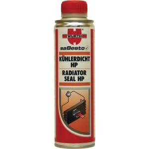

    Just put some stop leak in it for now. Wurth makes a good product, I have seen it work.

    Not only will it stop the leak but it will also block the core and eventually stop your car with excessive heat :p
    Best of doing it once and doing it right, Replace the gasket at your first chance, It wont get any better.

    Yep, definitely wouldn't be trying to stop a leak in the engine by using a sealer designed for radiators haha.
