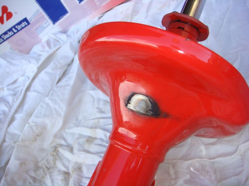

    You say you are fitting 18"s so keep your tyres to 235 as some 245's will rub on the strut spring seat.
    Mine was with 245/35x19's as shown which is why I went to Koni's.
