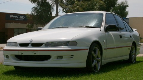

    Just picked this up yesterday VS SS bt1
    Pretty tidy inside and out, The guy i got it off was a top bloke and seemed very honest.
    Its got a couple of small faults that im on with fixing now before rwc on friday, got a strange one tho that i was wondering if anyone had any ideas about.
    If i open the car with the remote key, the passenger side front door and drivers side rear door unlock and the other 2 stay locked, if i use the key in the door lock all 4 locks unlock.
    If i lock the car with the remote the passenger side front door and drivers side rear door lock, if i lock the car with the key in the lock all doors apart from the passenger side rear door lock.
    Why would the one rear door remain unlocked when i use the key in the lock and how come if i use the remote the drivers wont unlock..?!?!
    Also has a leaky trans sump gasket which im changing today.
    Other than that the car is pretty much perfect, drives really nice and sounds awesome.

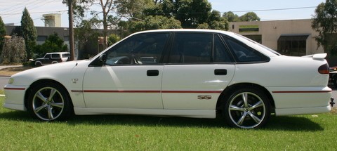

    those side skirts are wrong. theyre VN style, and look like copies since theyre one piece

    car seems pretty good though,i take it being a bt1 its had the bodykit fitted later?

    First mod should be getting stock sideskirts, those VN style look crap on anything other than a VN

    And the side skirts are staying where they are :whistling
