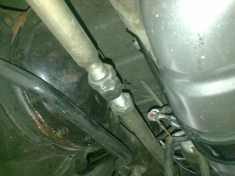

    I picked up this second hand pedders adjustable panhard rod yesterday and put it on, I presume it's on the right way. Took it for a drive today and noticed a loud knock whenver I cornered sharply, had a look underneath but couldn't see anything really obvious. Any ideas? I'm also curious to know what it is that is hooked onto the middle of the panhard rod. It looks like a spring that is connected to some sort of cylinder.....

    that panhard rod is missing a nut...
    ill take a pic of mine sometime this week and show you what i mean

    Yea if you could that would be good, I've just been driving it nicely so that it doesn't make the noise.
    Ah that makes sense, I'll put it directly below the end of the arm, cheers for that :)

    seems that your panhard rod is designed differently to mine
    what condition were the bushes in?

    Bushes were in good nick, no cracks or anything. Maybe I just didn't do the nuts up tight enough. I'll have to double check, thanks for going to the trouble of taking the picture mate.

    yeah np mate but would yo ubelieve i actually had to find the energy to go out to the driveway, get my phone under the car and push the bloody button!
    took all of 15 seconds.
    sad innit?
