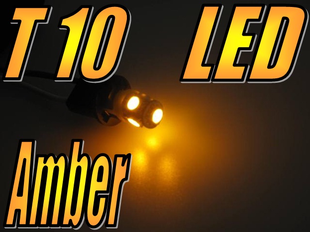

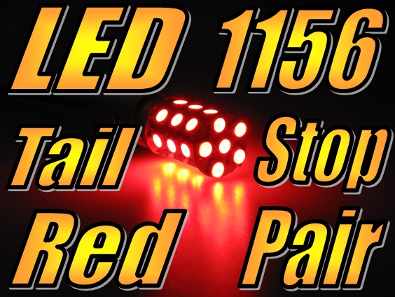

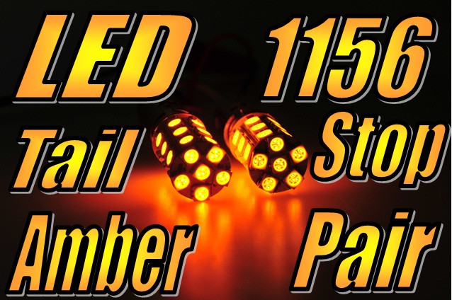

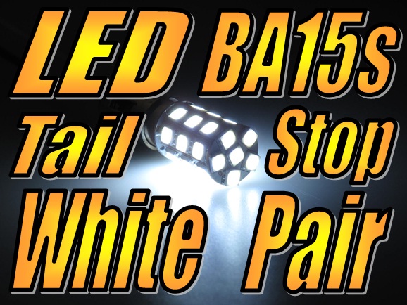

    I am considering buying a full set of LED globes for my 00 VX Berlina. I was wondering if anyone has had any experience purchasing these items and if they look aesthetically pleasing?
    For example: Do they interfere with the red tint already around the taillight/headlight housing? Like red led on red tint making a strange colour?
    [​IMG] [​IMG]
    [​IMG] [​IMG]

    You are better off using white leds with the red lens in the brake and tail lights.
    The red colour has a lower wave length than white and will not shine as bright through the diffused red lens.
