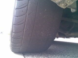

    hey mate, I have standard vt exec shockers with Pedders touring springs front and rear. I would like it lower in the front and pedders do a sports ryder spring that sits 1 inch lower. If your going as low as mine (not actually tha low compared to some) then you WILL NEED a camber kit. I have a camber kit and have a look at the pic of my last set of tyres:
    The tyres after 8000kays:
    Nicko

    666vt if you car is a daily then i woudlnt go much lower than mine or freaks in the rear. I scrap a fair bit and im very careful about it. Front never has a drama though
