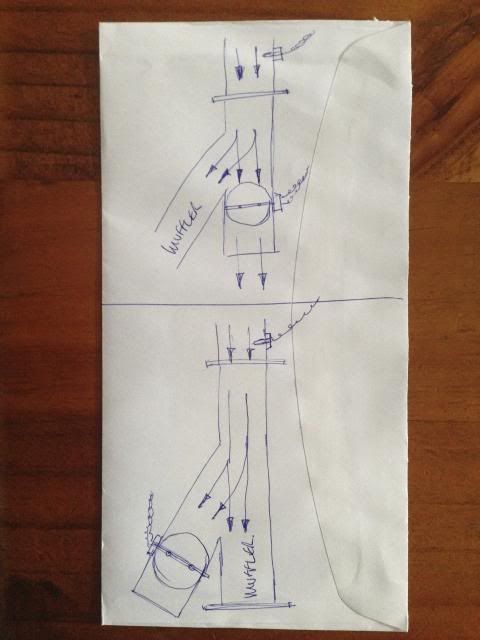

    I'm interested to hear of anyone that has fitted exhaust dump pipe valves on the Commodore. It would be good to hear from you.
    I've seen a few kits on the market but none are designed the way I'd like. The ones I've seen act as if there's a hole in your pipe. The flow to me isn't right. To much gas flow goes to the muffler direction and not out the dump pipe.
    Attached I've added a drawing. The top version to me looks as tho the flow would be better when the valve is open. When it's closed I'm not to bothered about performance. I'm more into the performance when it's open.
    The version below is the type you can buy off the shelf.
    Also, I'm looking for a 3" dump valve system. I'm running a Di Fillipo system.

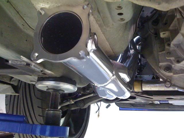

    Below is an image of a system you can buy off the shelf. Though the electric operated solenoid butterfly is a good idea the pipe design isn't what I'm after.

    Some hi-po performance cars are fitted with these from the factory including the ZR6 Corvette.
    You should be able to buy the valve by itself, then make your own merge pipe the way you want it. Personally I don't see to much of an issue with it, the exhaust gasses will take the path of least resistance so when the valve opens that's the way the hot air will flow. If you make small extensions of the valve and point it at each rear tyre it will help to make a good smoke show, although you seem to do just fine without it as is :)
