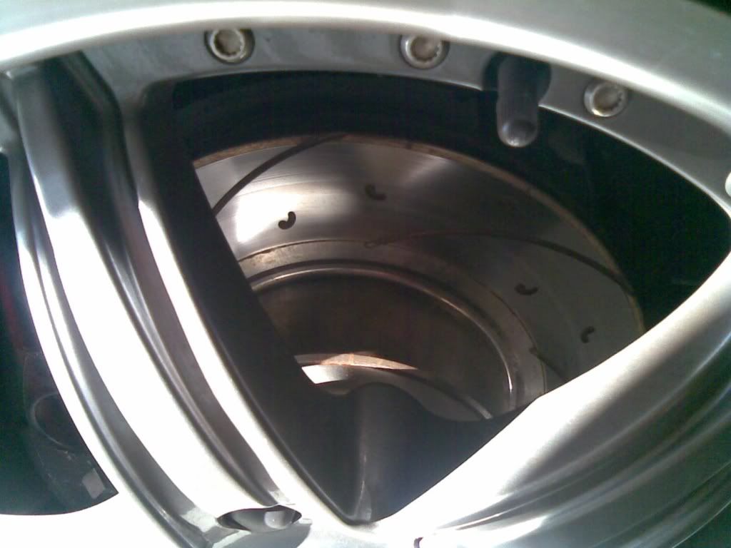

  7. Munz
    Munz Right Foot Action
    2,276
    Jan 23, 2011
    Brisbane NTH
    VZ Calais LS1 / VL RB30e daily
    more info on the curved discs please for standard VZ brakes and photo if possible
  8. Not_An_Abba_Fan
    Not_An_Abba_Fan Exhaust Guru
    13,813
    422
    Aug 18, 2006
    Bunbury, WA
    Strange Rover
    I'll get a price on them on Monday. What size rotors do you have?
    Picture below of the rotors I do on our Senator
