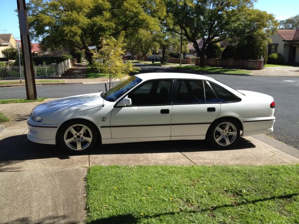

    yours would look pretty much the same as this one..
  2. VS-S
    Hmmm they look a bit too big :/
    Edit: Actaully staring at them for a whole they're starting to grow on me.

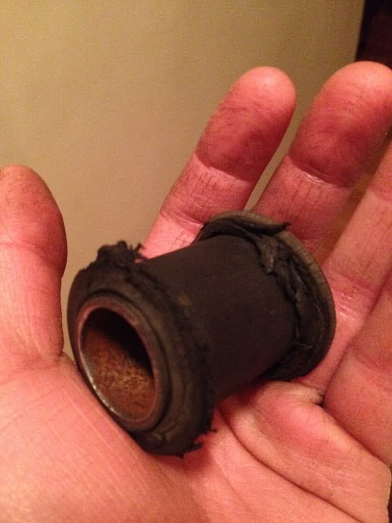

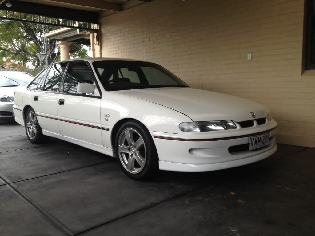

    Bam! Superlow!
    Had to get a new control arm and bush.
    Now on the hunt for SSV's!
    Edit: Front page has been updated.

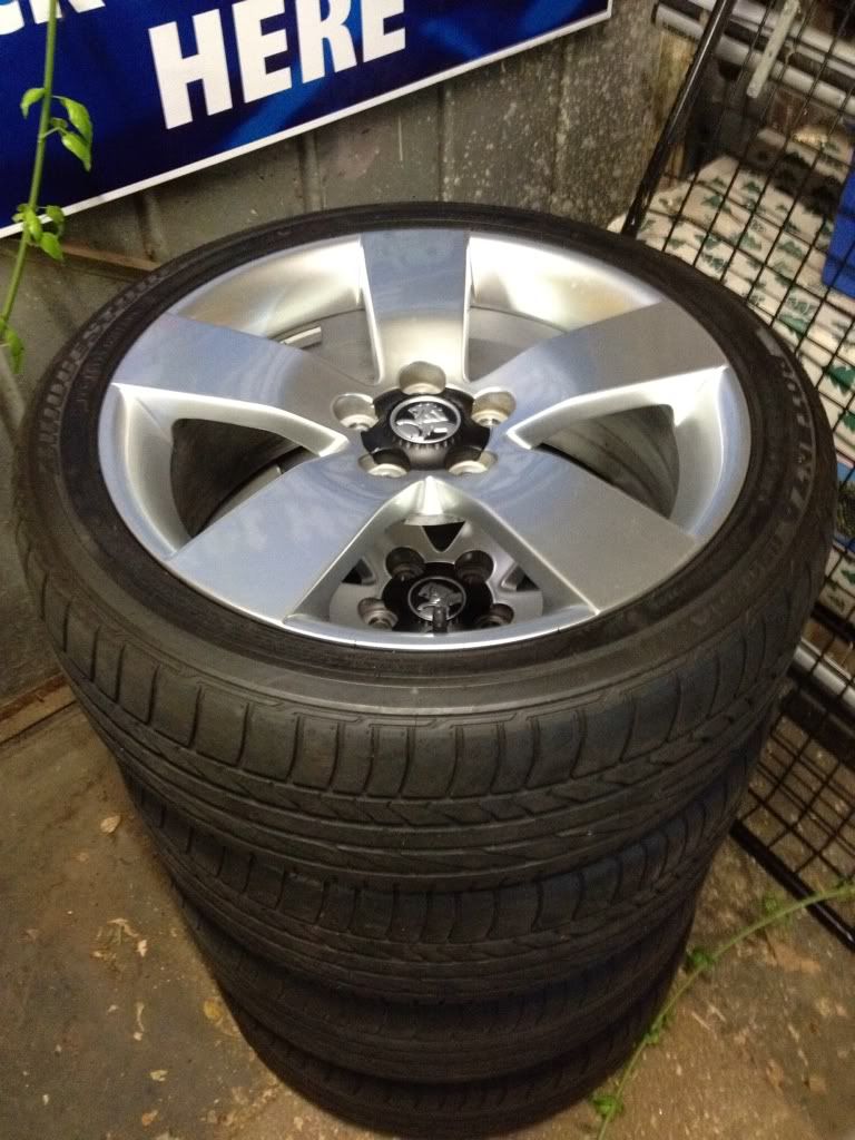

    Got these babies today. Still have to get them machined and some smaller profile tyres.

    Wheels are in getting machined to fit pre-commos and going to check out tyres today. Hopefully these rims get on the car tomorrow.

    Im after a set of ssv as well. They are 19's right ? I was told that you have to change the entire struts to fit 19's.. This is what i have been told, its fine right ?
  16. VS-S
    Thanks man yeah they should be on tomorrow hopefully.
    Yep 19's man. Just get smaller tyres. 235/35r19's should do it. You shouldn't have to change the struts.

    Hey no worries, just realized that I have to get 245/35r19's because of the total tyre load. Needs to be 95H for the VS. Just double check that on the tyre placard under your bonnet. And no dash upgrade for me man haha.
