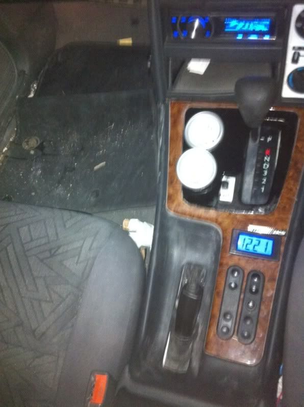

  4. Trayner
    mould it into your centre console like i did
