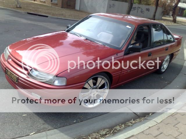

  1. [JUDGE]
    [JUDGE] New Member
    565
    Apr 7, 2006
    South australia , Adelaide
    2004 Black Vz R8 HSV Clubsport 297kw Gen IV M6
    Name:
    Troy
    Date Purchesed
    03/06/2008
    Model:
    1990' VN SS
    Colour:
    Phoenix Red
    Kilometer's:
    160,000Km
    Bodykit:
    Factory SS
    Letter box grill
    SS spoiler
    Engine Type:
    304Ci 5.0Lt V8
    Engine Mods:
    Re-conditioned Motor
    Mild head and cam package [apparently]
    5L OTR SS Inductions
    K&N Filter
    9mm Eagle Extreme Leads
    Plugs
    Performance Chip
    Thermo fans hooked up to switch
    Line lockers hooked up to switch
    Power:
    Exhaust:
    Full exhaust system. Advanced Extractors 2.5" pipe all the way through middle muffler into rear resi with twin tips.
    Gearbox:
    T5 5 speed
    Billet Short shifter [Lagit, not just cut down]
    Extreme Heavey duety clutch [Purple type]
    Diff:
    Factory LSD
    Standard differential ratio 3.08
    Brakes:
    Stock V8 on the rear
    Sloted rotors on the front
    Suspension:
    New bushes all around
    Pedders shockers new all around
    Pedders SL or UL springs
    Pedders strut tops
    Wheels/Tyres:
    17'' Calais International's
    Toyo 235/45R17
    20" Advantti Racing chrome rims (Fitment in process)
    Interior:
    Standard ss dash/seats/door trims
    Isotta gear knob
    Power windows
    Power mirrors
    Central locking
    Gas bonnet lifter in boot
    1Kg fire extinguisher mounted behind rear fold seat
    Exterior:
    Tinted windows
    Custome slim design plates black/gold [MRVNSS]
    8mm wheel spacers on front rotors
    New/Replaced :
    New Water pump
    Radiator Reconditioned
    Clutch cable
    Front bumper support clips
    Interior/exterior globes
    Crystal blue headlights
    New wheel studs +15mm longer
    Rear main seal
    Spicket bearing
    Thrust bearing
    Stereo:
    Pioneer head unit
    Pioneer 4" 2-way 120w
    Pioneer 6" 3-way 220w
    Pioneer 6x9 5-way 480w
    Alpine Mono-block 1000RMS amp
    Kenwood 4- Channel 480w
    2x Cadence subs 350RMS ech
    My car on All Car Cruise 28/02/09
    With 20's fitted.

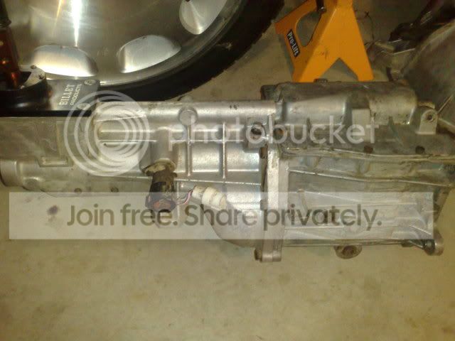

    well been having some gearbox/clutch issues...
    so the whole drive line, box and clutch is all out.. cars in peices everywhere lol =[
    gear box seems fine, clutch seems very good since it was replaced brand new before i bought it..
    thrust bearing needs replacing and we replacing the spicket bearing as well as the rear main seal while its out...
    hopefully this will sort out the troubles ive been having. Will be giving the box and few other bits a nice bit of degreaser ..will post pics soon!

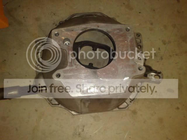

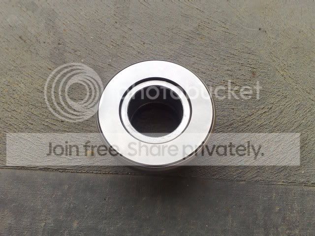

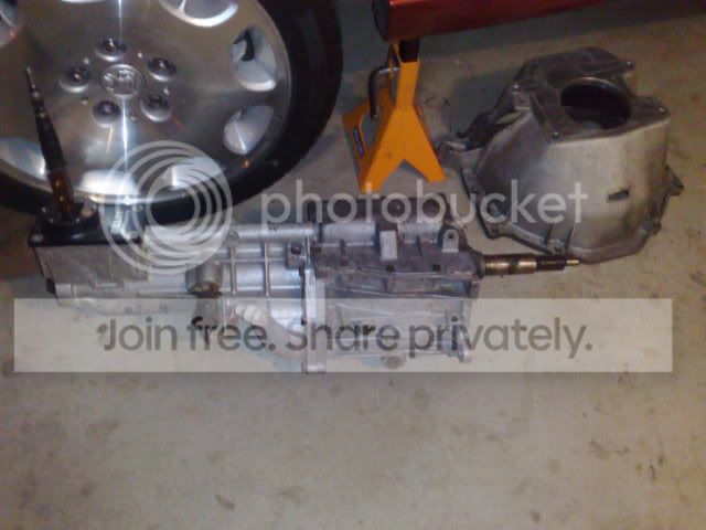

    Here's a few pics of whats been happenin.
    Car on ramps box and all components out..
    Pis of the old bearing..
    And now new bearing..
    Picture of the ol clutch... still yet to pull it out n see what condition its in...
    Some pics of the filthy box..
    And after going at it with some degreaser and a steam cleaner..

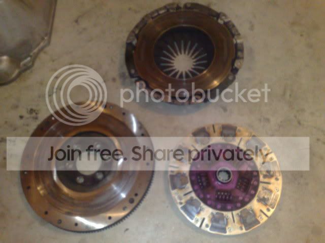

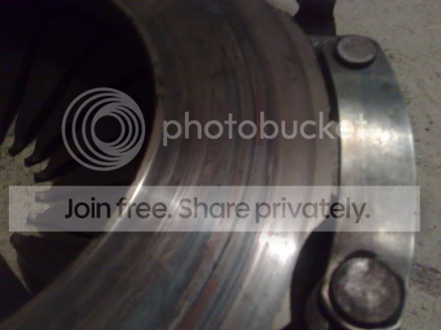

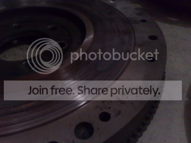

    Well after getting back into the garage today and pulling out the clutch and flywheel...
    I think we found the source of the problem..
    Looks like a new heavey duety clutch and new flywheel are on there way asap!
    So as of a few weeks a should have pretty much a whole new setup excluding gear box..
    We will be replacing Real main seal, thrust bearing, flywheel, heavey duety clutch, fixing hand brake while we're there and spiket bearing.
    Any help as to what brand/type of clutch i should put back into the ss would be appreciated..
    Here's a few pic's..
    The cause of the problems.
    No meat at all on this bad boy..
    And you can see in these pics the fly wheel and clutch have been worn down a few mm or so its that bad..
