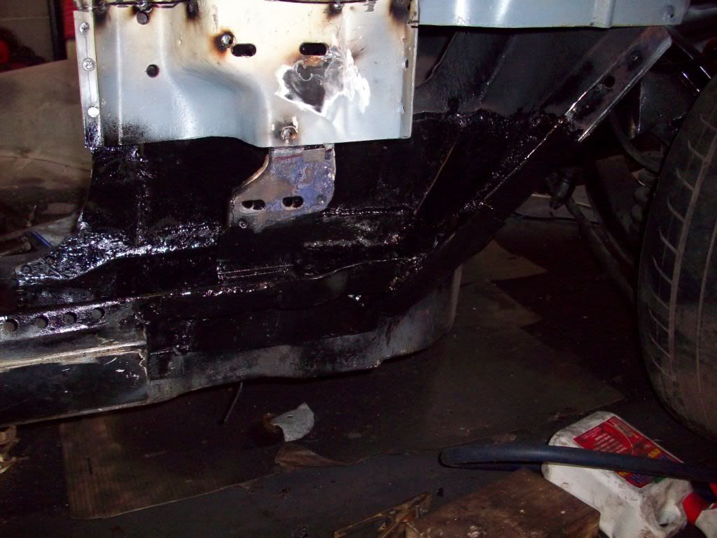

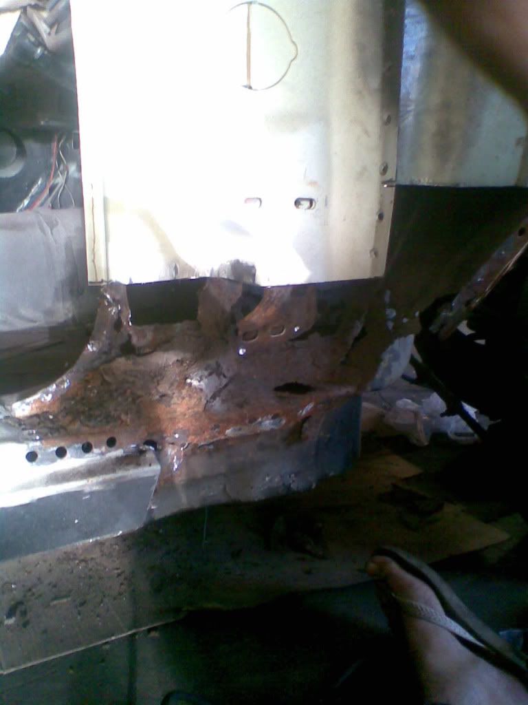

    during:
    and the after pics will take me prolly till the end of this week. oooh yeah, my windscreen arrives tommorow AM :)
    LMOA, just noticed the pic of my thongs/safety boots

    Hahaha you're a bloody OH&S nightmare you are :p
    Can't believe how much more rust was behind that panel. Nasty stuff. Have you ever gotten around to attempting your sills again?

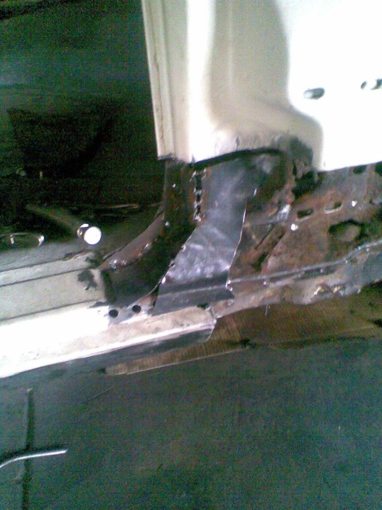

    well, my mate "finished" the passenger side sill, so i need to rub over the bog with fine finsh bog to fill the little holes and stuff, so thats all good. those pics above are of me attempting the next patch, these ones are the start on the patch
    in place
    i was watching my mate do it like a jigsaw puzzle, whereas when i went at it was trying to do it with one piece of metal. during the whole process, the patch looks like shite and i was thinkin "oh, thats so bad. i dont want that crap on my car, my mates an arsehole etc etc etc" but once we layered bog on it and finished it off... it actually looks perfect. i cant get a decent pic cos no light on that side of the shed, but yeah. itll be painted this weekend :D
    and yeah caliber, this is about my 4th "project". every other one has ended up in bits on the back of a truck heading to the wreckers. i swore to myself i was ACTUALLY gonna finish this one, and now i have spent too much cash on her to justify selling or scrapping. so i have no choice ;)

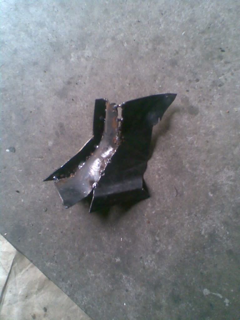

    check this out:

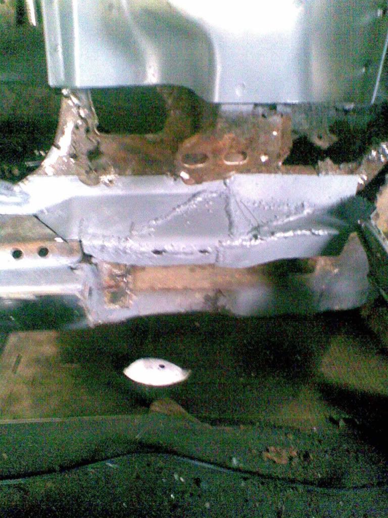

    so my mate took two months to finish the passenger side patch, claiming it took him 24 working hours and blah blah blah.
    i knocked this one up a bit of yesterday and today, 6 hours total (i still gotta grind down all the welds etc):
    i think i have my confidence back with this stupid rust patching business...

    woooooooooooo that is one IMPRESSIVE patch you have right there :) That's a work of bloody art!
    Gives me a bit of inspiration for when the time comes to patch mine up, too. LOVE your work. If you can do that, you can do anything, really :p

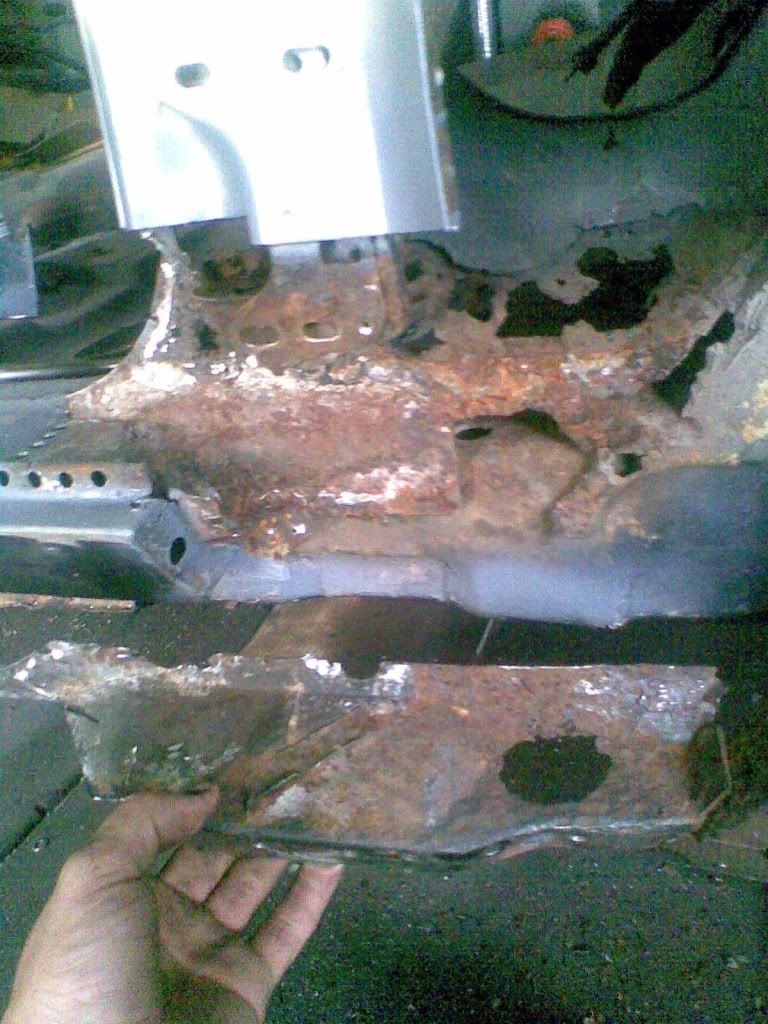

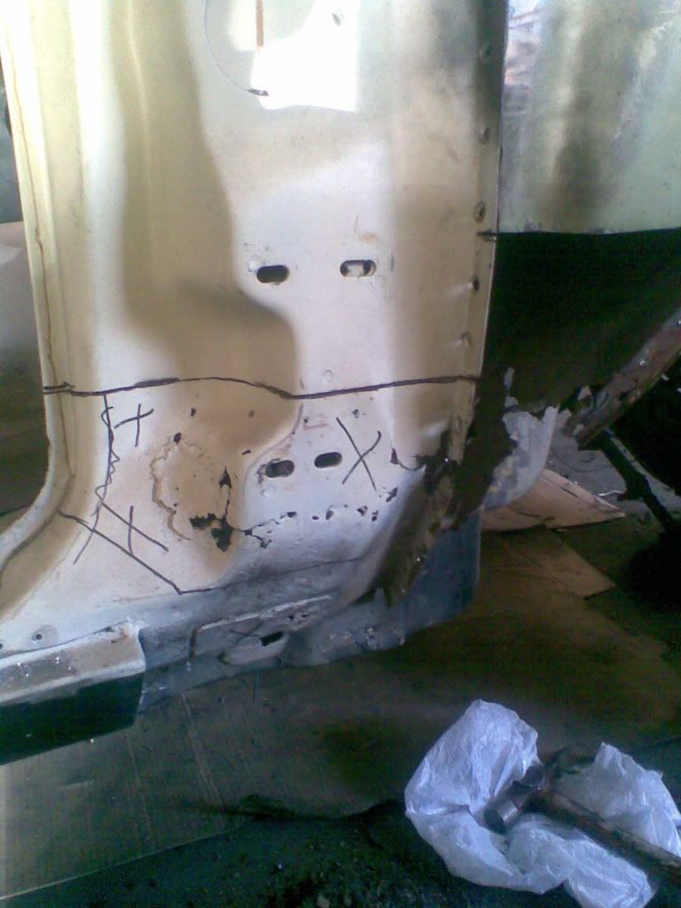

    I noticed in the pics in post 142 that the inner structure of the pillar was pretty badly corroded. Have you repaired the inner skins or just replaced the outer? That's a critical area of the car for strength and it really needs to be repaired fully to retain the car's structural integrity.
    My apologies if you have done it - it's just that the pics don't show any inner structure repairs.

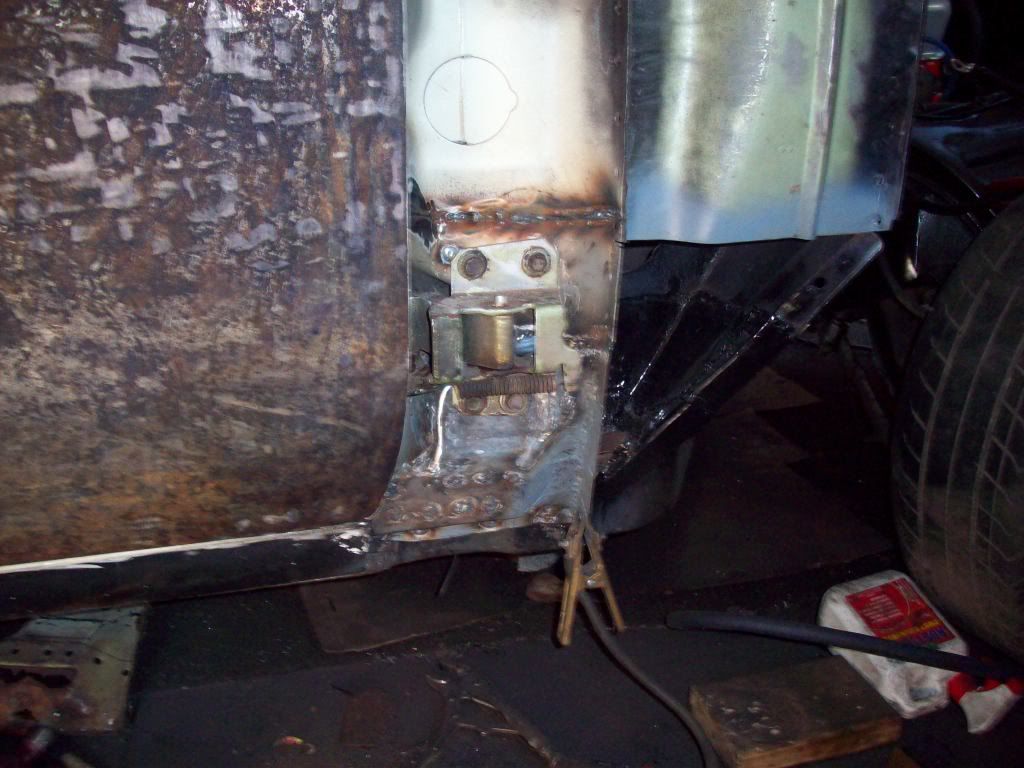

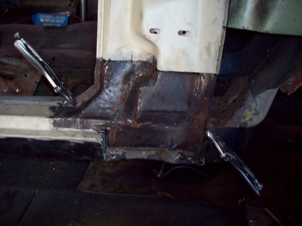

  11. ari666
    stuff structural! thats where my speakers are going! lol.
    yeah mate. on the passenger side i cut out all the rust first (4 panels worth), then made patches with the bits i had taken off the car which really overcomplicated things cos i ended up just guessing a lot of it. this time i decided to do it a little bit different, i.e take a patch off, make that patch fit with everything, then take the next one off and make it fit with everything and the other new patch. it seems to make a lot more sense. so i have done the vent channel cover and outer pillar (the pic shows outer pillar with vice grips holding it in place). was gonna hit the sill and the inner wall yesterday but it got to 39 or so degrees which equals 6000 degrees in the shed, so i got drunk with a mate instead... gonna hit that today cos' it quite nice temp in there atm.
    i struck another hurdle yesterday though, put the radiator in, plumbed up the hoses and tranny lines. filled it with water and out the water came. there must about 10 small leaks in it which means the water just flows out... great... just what i needed, another 500 or so bucks which i dont have till next year cos' im on holidays. i dont understand either, the rad was fine when i took it out. must have just opened some holes by sitting empty for so long.

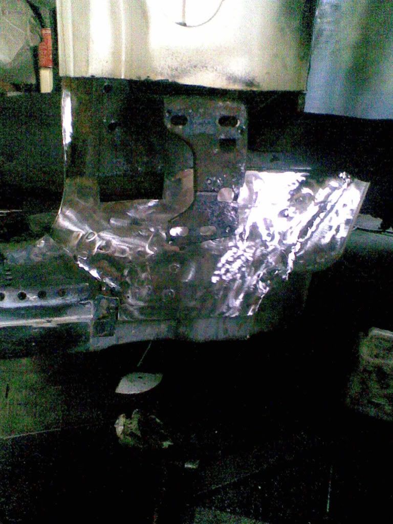

    sweeet! wheres the pics? huh? i dont see any pics :p maybe we can swap storys about the nightmares finding parts. but keep me in the loop about the lowrider shocks, cos' even though i am not gonna do it with this one, i have found a guy in the states that wants to bring cars over here/modify and sell, so might be looking into it in the near future.
    anyway, some cutting and patching photos while my lamb is cooking on the bbq...
    sill panel off
    sill panel patched
    the three patches so far, another two to go but they get welded straight onto the body.
    and the hole that is left after it is all cut out :S

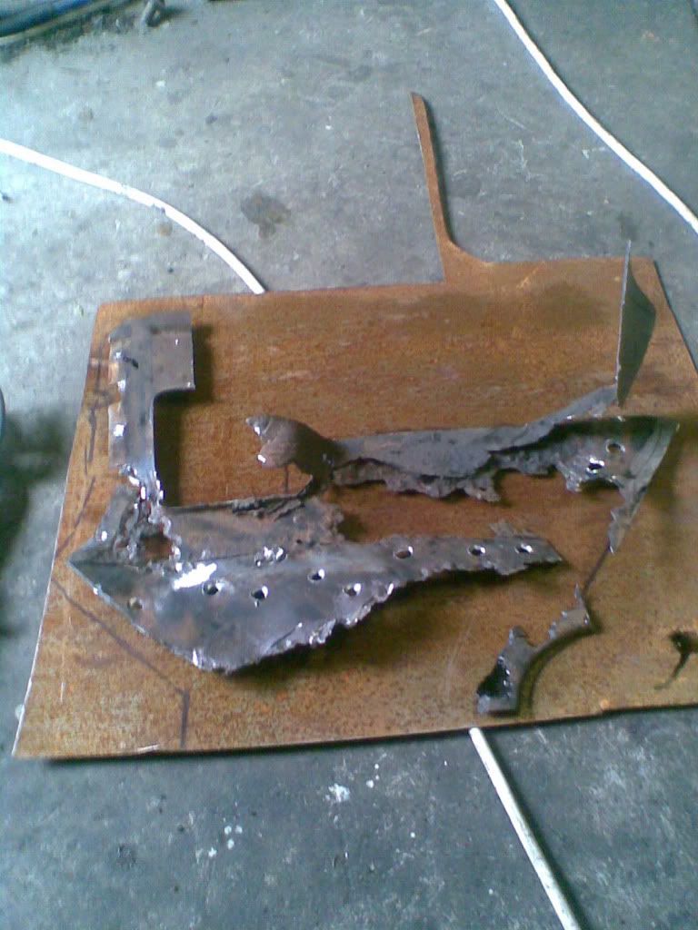

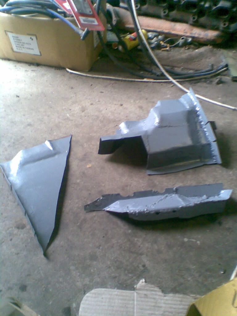

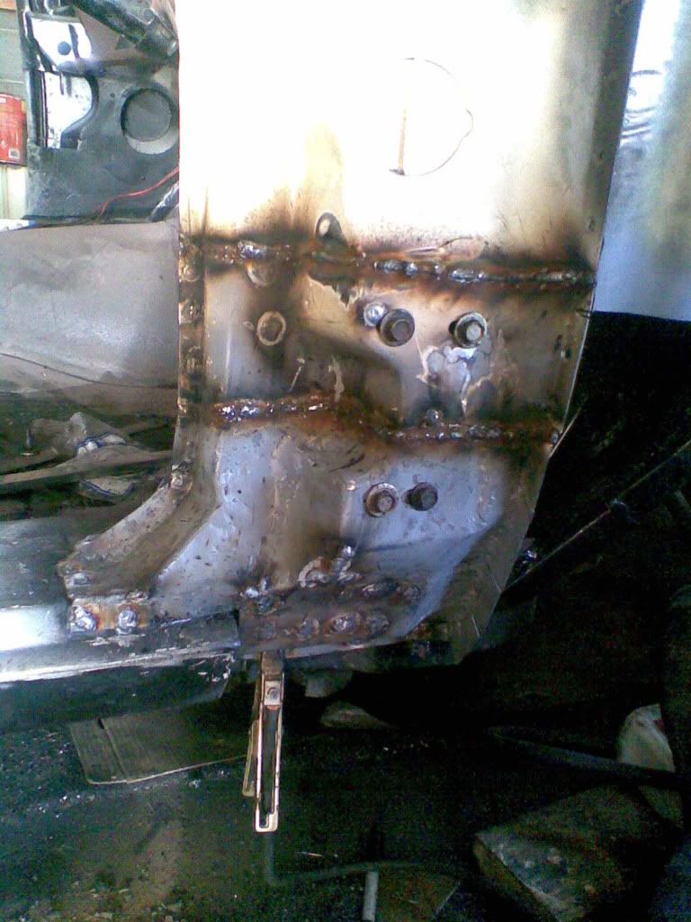

    well, its lunchtime again, so while my food cooks i post pics..

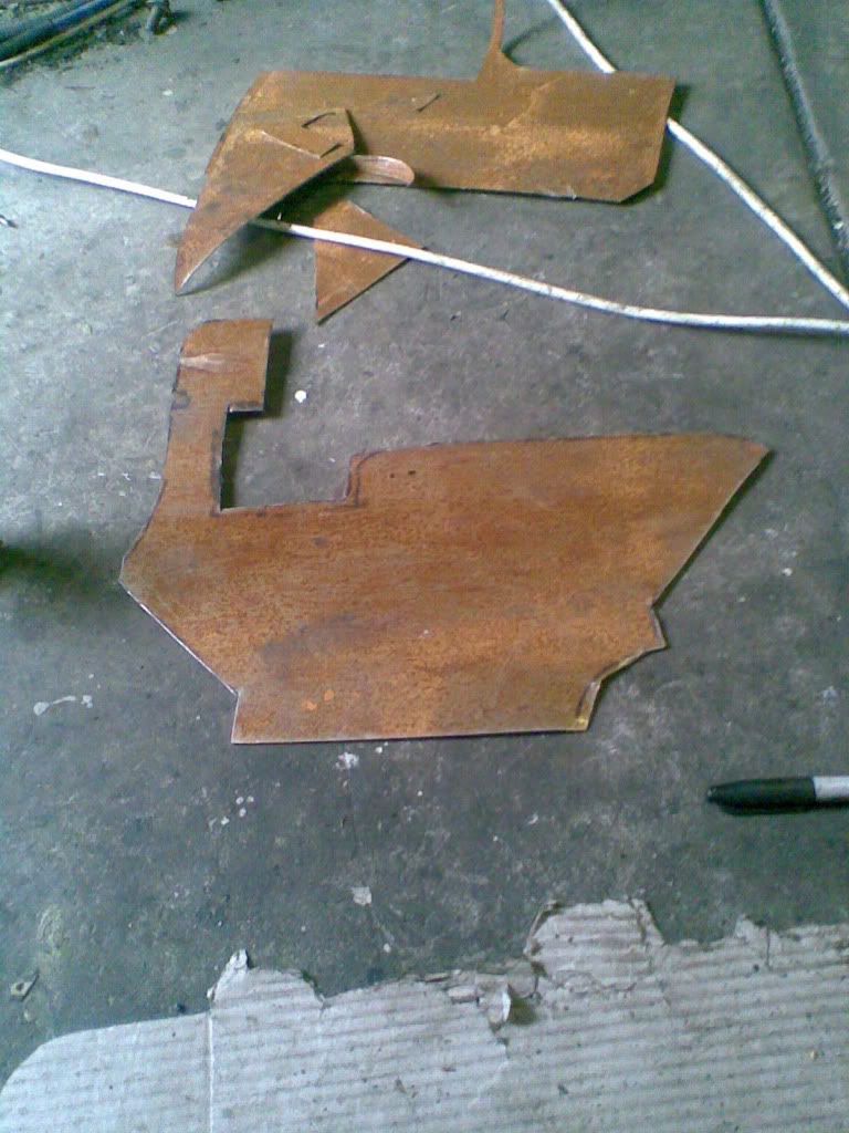

    this is me making the inner sill patch, using the old rust as a guide
    the patch cut out
    and installed
    got the sill inner and outers on, the vent support and blown some aerosol can black on it
    i have the door bracket to line up and weld in place, the outer pillar patch and the vent channel patch to go. dunno if i am going to meet my personal deadline of "having everything in and bogged" by tonight, but will see.

    IT FITS!!! FINALLY! :D :D :D
    Dude - at this rate, you could build another entire car from scratch using templates :)

    I don't think I've ever seen so much rust being replaced. Did you know it was as bad as that when you first started the job?
