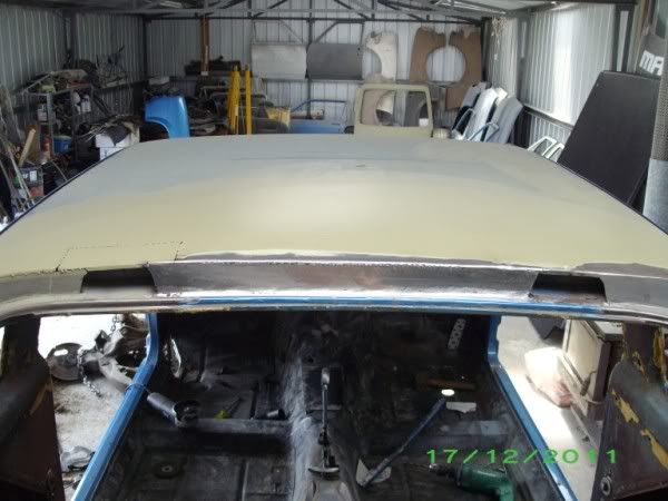

    There was an old repair in the centre of the roof between the hatch hinges that i wasn't happy with, so i cut it out. Then when i cut that out, i found the inner panel was rusty (didn't get any pics of that), which involved drilling out the inner roof support to be able to cut out and and replace the panel that was rusty, then welding the support back in. It was a bit of a mission, but i know it's done properly now, that's for sure.

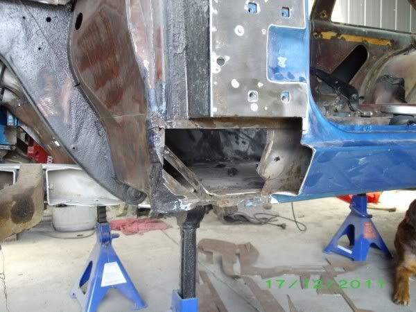

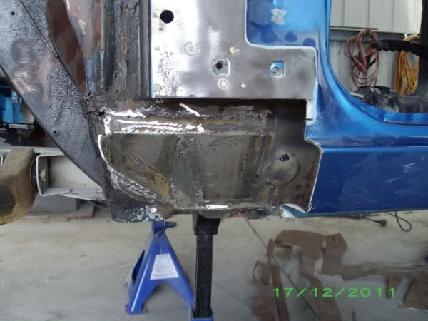

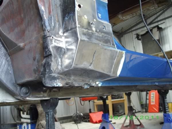

    Then i dug out a bit of rust in the inner sill panel (was under sound deadener matting), so i had to cut the front part of the outer sill panel out, then cut the inner out and rebuild it. I got it all cut out and got the inner all made and welded back in, i made a start on the outer which i will finish tomorrow.

    The roof repaired

    Inner and outer sill cut out:
    Inner welded back in:

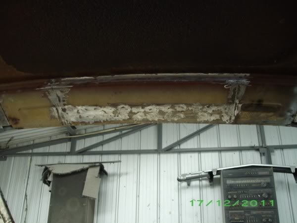

    Anyway, here is what i got done for the rest of the day.

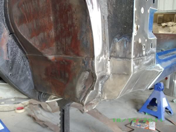

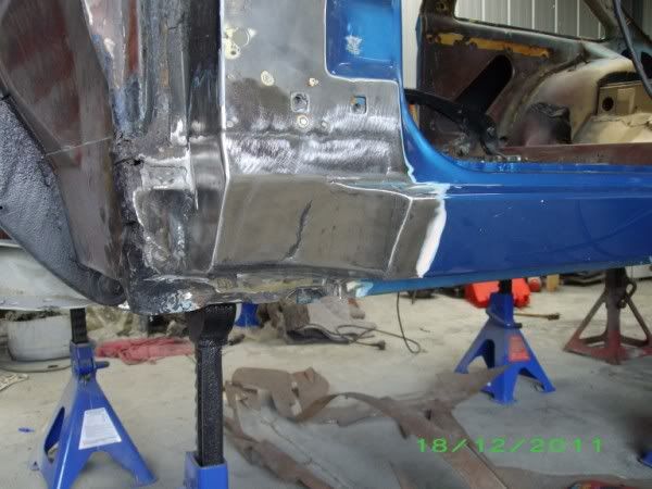

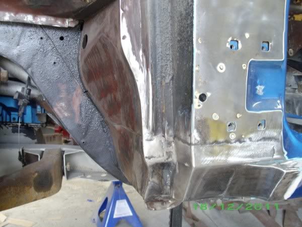

    I fixed the dodgy job that was done on the lip at the back of the front wheel arch. This is a common problem on Toranas when trying to fit big wheels on the front, and the person that had it before me decided it was a good idea to smash it over with a hammer. This always bugged me and it looked dodgy and rough so now was the time to fix it.
    Once it's been smashed over, it's pretty hard to do anything with it apart from cut the lip right off and seem weld the join, which is exactly what i did. To be quiet honest, with the size tyre i'm running on the front, there would normally be no need to touch the lip at all (big wheels have no place on the front IMO :p), but the damage was already done.
    You can see how it was in the photos of fixing the sill. I will do the same on the R/H side aswell.
    Here it is now:

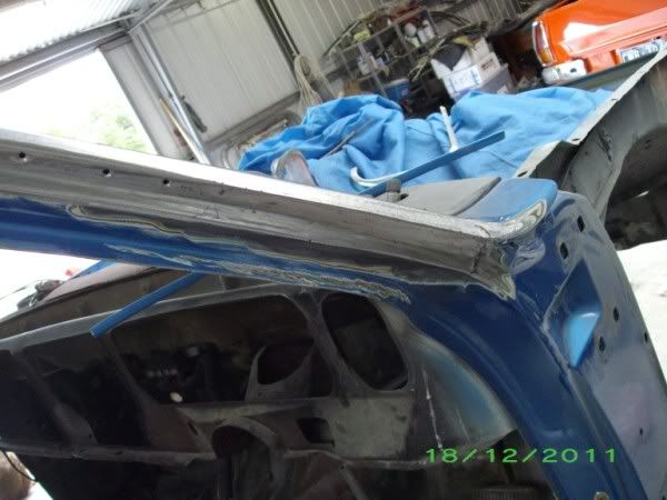

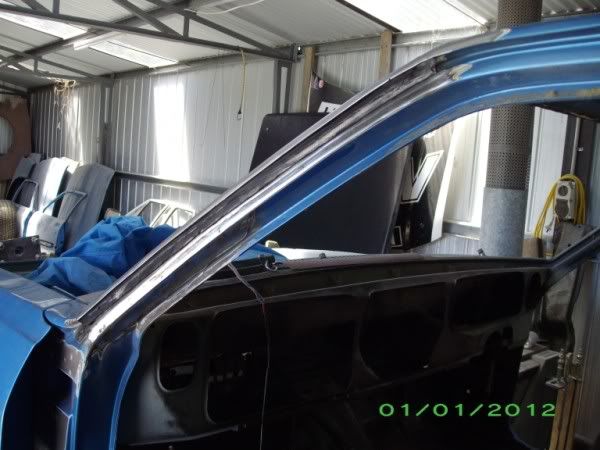

    I also got the rust repaired in the R/H A pillar:
    I just have to weld the rain gutter back on both A pillars now (i had to do the same on the other side).

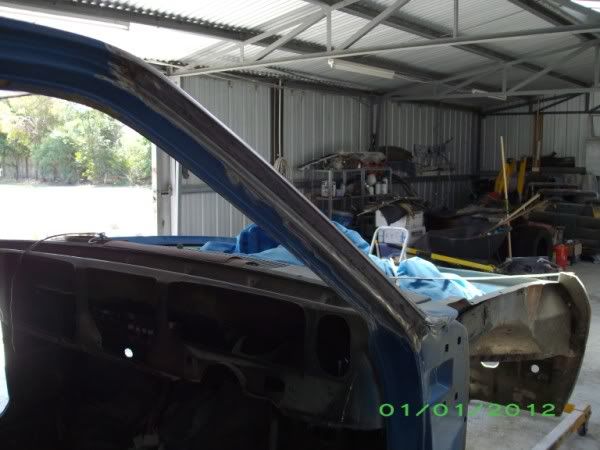

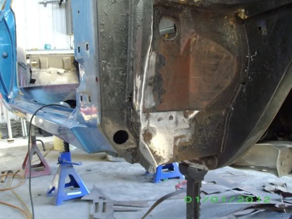

    Today i finished off both A pillars which involved welding the rain gutters back on and finishing off all the welds. With that done, i moved onto tidying up the lip at the back of the wheel arch on the drivers side (same as the left side, it was all smashed over for wheel clearance). I just cut the lip off and seam welded it like i did with the other side.

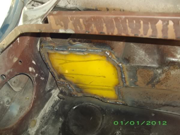

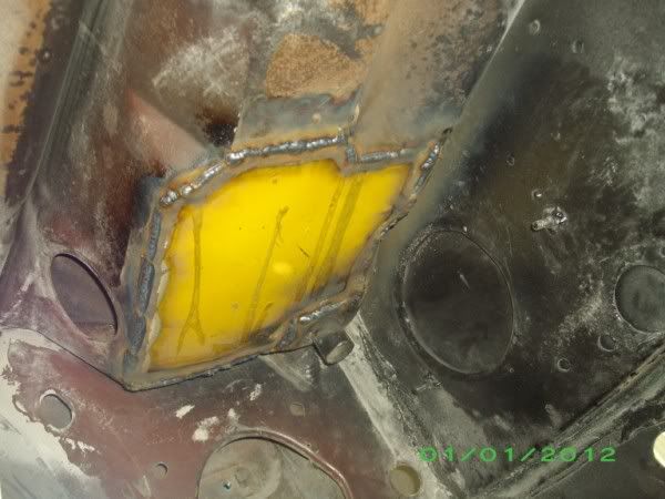

    Then i got onto one of the jobs i've been putting off because i knew it was going to be a bit tedious. There was the usual rust in the plenum chamber on the passanger side(this is right up under the dash). So i cut it all out and welded a new section in. This section usually has a big hole in it for an air vent, but considering my car will have an underdash heater this time, there was no need for it, so i just made it all flat.

    L/H A pillar and rain gutter all done
    R/H side
    Lip on the front wheel arch

    Plenum chamber (excuse some of the welds, that's as good as you get welding on your back with sweat pouring off you) Just need to tidy up the welds and seal it all up.
    That's all for now.
