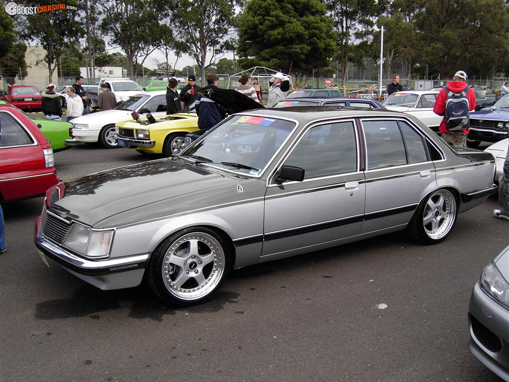

3. I'm keen to put a set of Simmons FR-1's on. I'd love to get my car to look like the pic I've linked below.
Not interested in the rubber-band look and still want to maintain good ride.
My guess would be that these are 17" or 18" wheels. Would love to get some advice on suggested diameter and tyre widths front and rear. Would also like to get this stance and would be interested to get advice on whether you think this is on super-low or standard lowered springs. I don't want to roll guards or mod the diff so basically just want to know what works best with the standard setup with lowered springs.

Answer no1. U have two many questions with alternative questions. Answer no2. U r lazy. Answer no3. Dash issues you would be best giving to a auto elec with the gauges you prefere to fit as you seem to have someones headach. Answer no3 engine or ecu? Numbers could possibly assist. Answer no4. Rims n tyres. 225/60/15 rear on interceptors or 235 with the lip rolled with the car 4 inches off the ground. Fe2 springs and 18x8 might be a consideration without guard issue with a correct offset. Possibly as per the pic..Answer no5. Maybe rare spares could assist with door molds.

I have a VC, which is 2" lower than standard, with 16X8's CSA Prowlers and 225/50X16 fitted.....I think the stance is nice, as the front guards sit just above the tyre and the rear sits just over the tyre.....
I didn't have to roll the guards, but had a little bit of experimenting with an adjustable panhard rod to make sure the left rear tyre didn't hit the guard, with a little weight in the boot....I did nail it in the end and the car is very comfortable to drive around town and out on the open road
G'day mate, thanks so much for your detailed reply. This info is very useful. I would love to see a pic of your car to get an idea of the stance if you have one. Cheers and thanks again!
