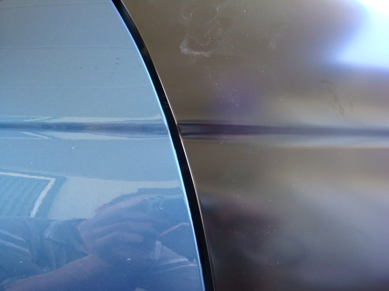

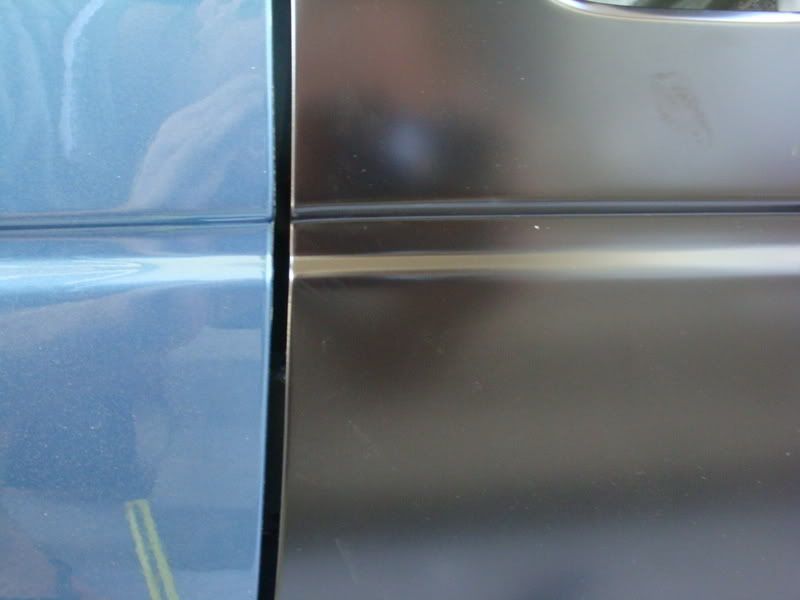

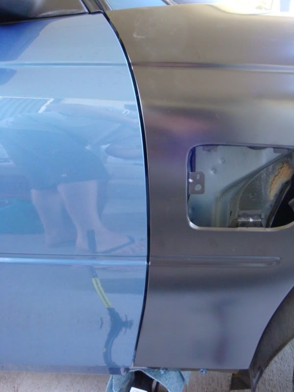

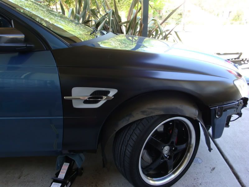

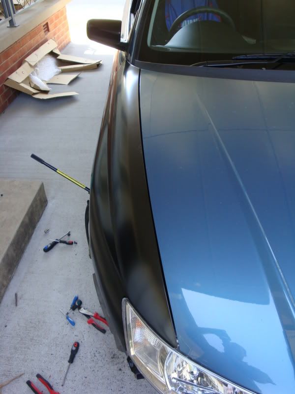

  14. andyman
    andyman The Only 6sp VZ Wagon
    3,783
    Mar 29, 2005
    Orange, NSW
    2012 BT50 4x4, 84 Hilux 4x4 & 05 Husky TE450
    chucked my non gen. panels on today to see if they needed adjustement before i got them painted,
    this is how it went on basically by itself, not real pushing or shoving into shape
  15. clubsport_replica
    clubsport_replica New Member
    208
    Dec 28, 2008
    Perth, NOR
    1998 vt clubsport replica
    if thats not bolted on then that would be a good fit when finished, just really need to try and get the gaps right when tightening it all up
  16. andyman
    3,783
    Mar 29, 2005
    Orange, NSW
    thats bolted on, but basically how it sat when i bolted it

  18. andyman
    3,783
    Mar 29, 2005
    Orange, NSW
    these are made in thailand
  19. Calaber
    4,335
    1,350
    Nov 29, 2007
    Lower Hunter Region NSW
    CG Captiva 5 Series 2
    Well, I have to say that they look damn good. Panel margins are even, no ripples or damage and I assume they fitted straight on pretty easily.
    Andyman, perhaps you were just lucky, but they seem ok.
    Are the vent inserts copies too, or the real thing?
  20. andyman
    3,783
    Mar 29, 2005
    Orange, NSW
    vents are genuine
