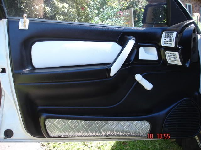

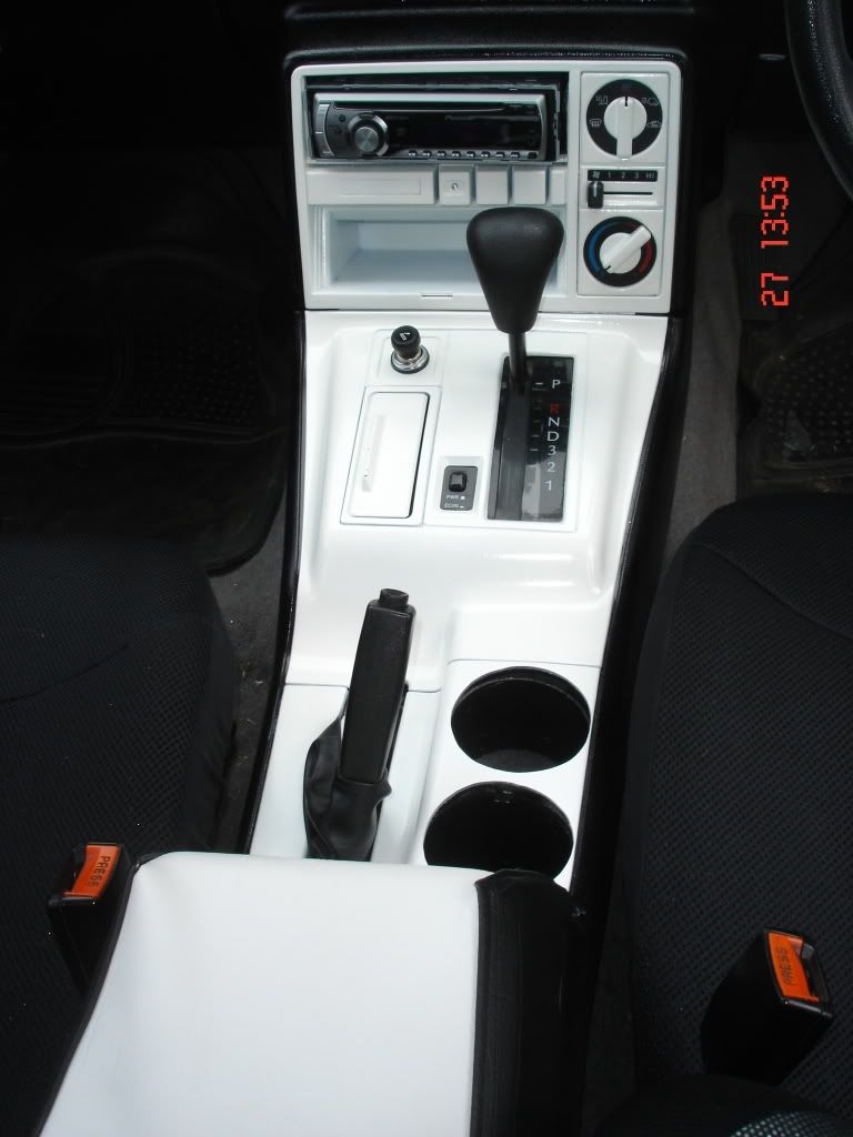

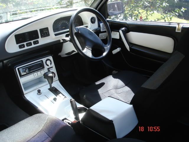

    aye dude i think i just replied to ur headling thread, well here is the rest of my car
    I've also painted the top of my dash black since these photos so i'll try to get a pic of it over the next couple of days or so

    i reckon go for it mate. pulling everything out is easy, its putting it all back together trying not to scratch anything thats a bit tricky. Theres a how to on here about installing a headunit and thats got details of how to pull most of those bits out.
    r_i_d_a_h did u take ur dash out when you painted it? i did mine with it still in the car and i couldn't quite get the spray paint the other side of the hump where the speedo is, it just looks a bit patchy. how'd you get aorund that problem.

    Hey dude, as for cleaning and pre-painting all i did was give it a wipe with a damp cloth and a tiny bit of washing up liquid then let that dry and sprayed vinyl dye straight on top of the vinyl bits and black and white gloss enamel on the plastic bits. Turned out pretty good without the primer, i guess you could use primer if you wanted to.
    Then for the vinyl roof and inserts i just went to Spotlight and bought some black and white vinyl, i think it was about 15bucks a meter and i got 3m of white and 1 mt of black. That was enough to do my roof, parcel shelf, door inserts and center console arm rest and i still have about half a meter left over.
    The inserts on the doors are just re-covered ones from a calais or statesman, cant remember which. I think i paid 15bucks for 4 at the wreckers.
    Give yourself plenty of time and dont rush, make sure you have all your materials before you start and get a little more than what you think you need.
    Hope all this helps and good luck with it. Wouldnt mind seeing the results once your done too. Let me know if you need any more help.
    Jack
