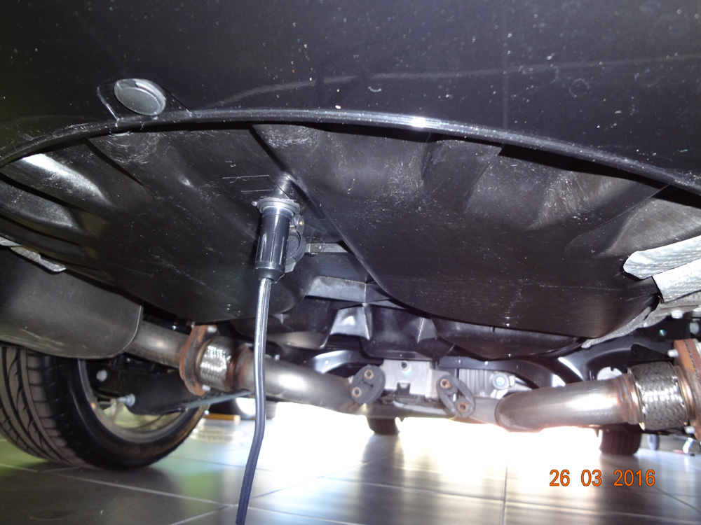

    I still use this system till today, I only duplicated it on the Caprice V only 4 weeks ago as I have the car for 7 weeks only and works very good as I have a Projector Charger next to a power point (Added more PP when needed) so its plug under the car and turn the Power point on. Also Don't disconnect anything
    The VF Storm and the WN Caprice V + the other cars I have that are not used or even registered but like to start them up fortnightly.

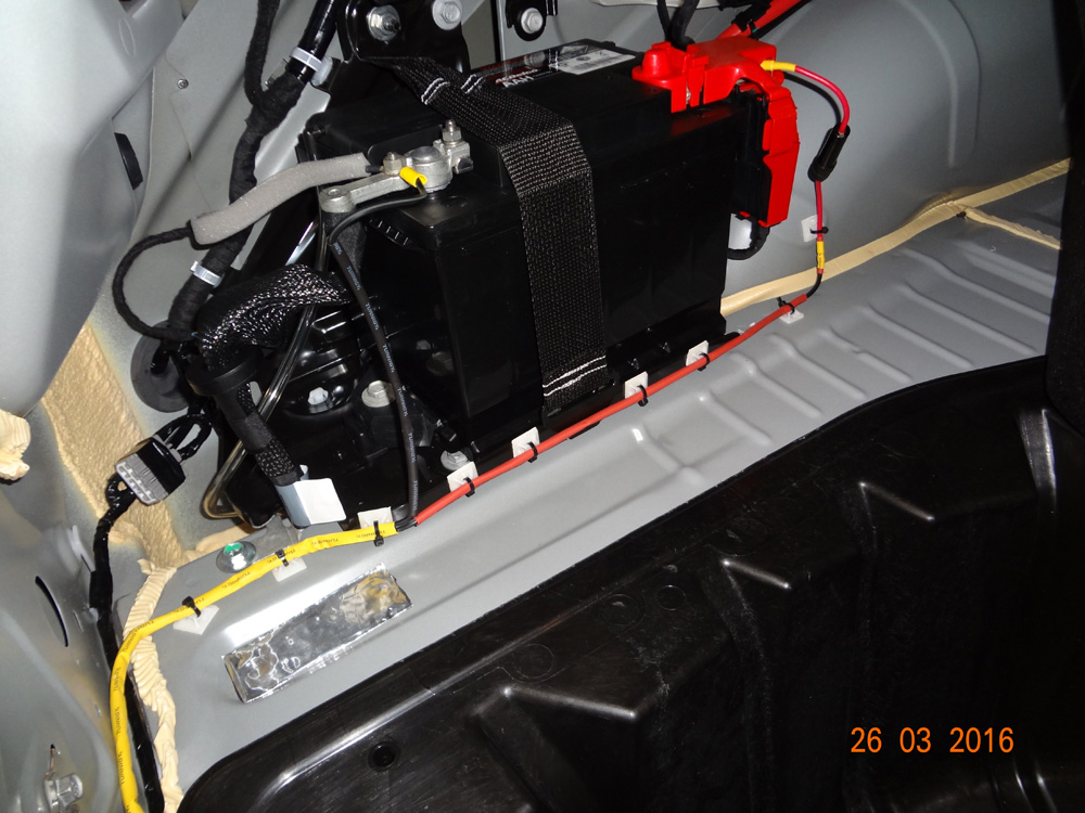

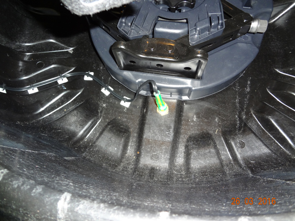

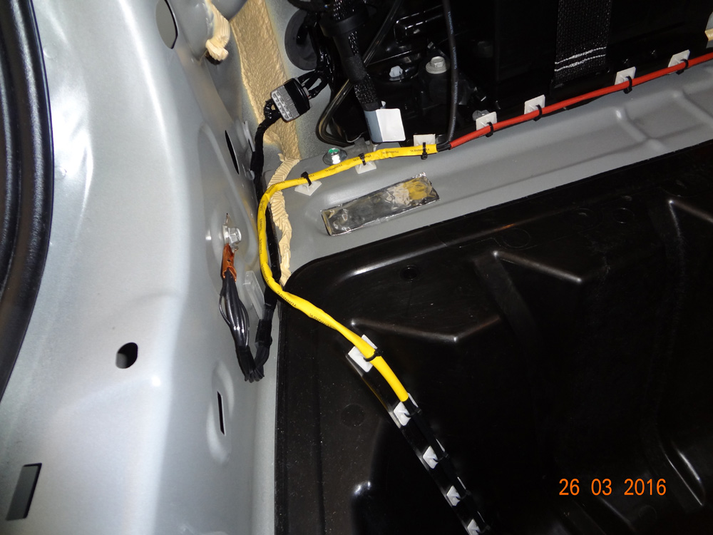

    Inside boot, Tyre removed.
    Connected across the Battery, Protected by a in line 10AMP fuse. Don't disconnect anything when I charge.

    The wiring clip store called, they want to know if you need anymore..
    Philmecrackun and KING46Calais V like this.

    No I get them cheap from Bunnings, Can't say the cable will come off LOL + using less of the cable supports the cable is all over the place and if this happens I wont sleep at night. Although I tried to straighten the cable out but the cable has its own mind.

    Wow a lot of clips used
