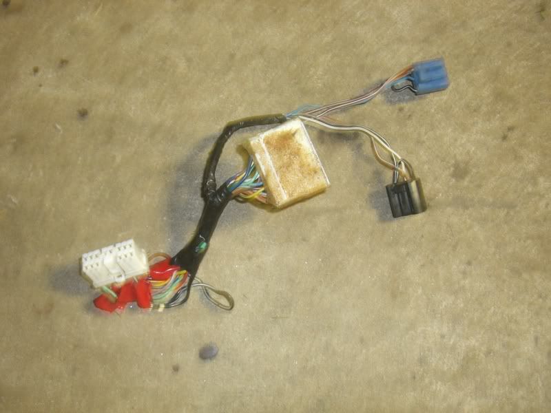

    Heres what the plug looks like. Wont be blue (thats for non climate air con), they'll be white or green (Probably green)

    ^ thanx for the pic, nothing there like that.
    Only wiring there is for the climate control and the power windows. (all the rest ate shifter, lights and cig lighter etc).

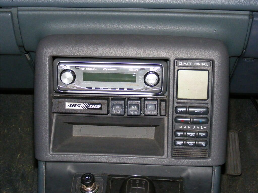

    Whats switches are you talking about? Your talking about these right?

    ^ yeah just put all that back in, mine are where yours say rear wiper and fog light etc.

    In the pic i posted above, they would go where the 3 switches are next to the ABS/IRS badge (one of the 3 would be the light for the immobiliser)

    Had a pretty good look, Ive had all the interior out bar the crash pad and there is nothing like chopped wires or any connectors that resemble anything that something thay would fit the switches.
    Mine is as above, has two switches, one up and one down, next to the abs/irs decal.
