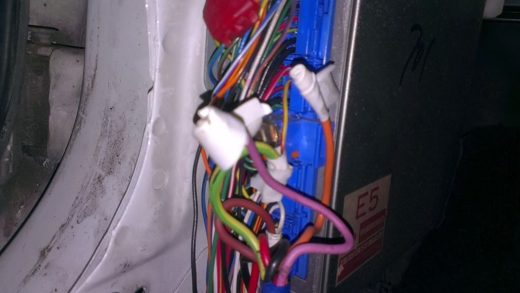

    Just so you know too, there's a pretty good chance that Nistune board might not work with the Type X ECU. The regular S13 and Type X use a different board because I'm fairly sure they have a different ECU and a few wiring differences. Can look it up -http://www.nistune.com/equipment-products.php

    Well you got the lights and the S13 black top SR20 which is a Type X motor, so you'd want to be damn sure. P/N of the ECU will tell you what you need anyway.

    Yeah the garnish and lights as well. I thought all 180sx came with the S13 non VCT blacktops? I have a picture of the ECU somewhere, will check the ECU sometime anyway. I figure if I'm gonna rebuild i may as well got for a GT3071r and spend the dosh for some power, I would like a bit more compression in the engine so it has a bit more push when then turbo isn't spooling. What do you mean by response from the turbo?
