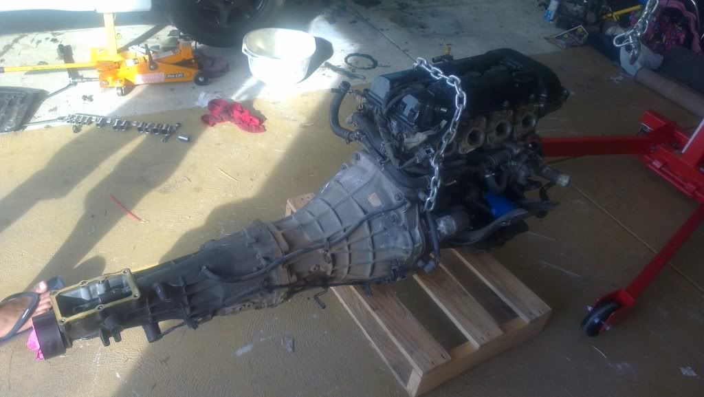

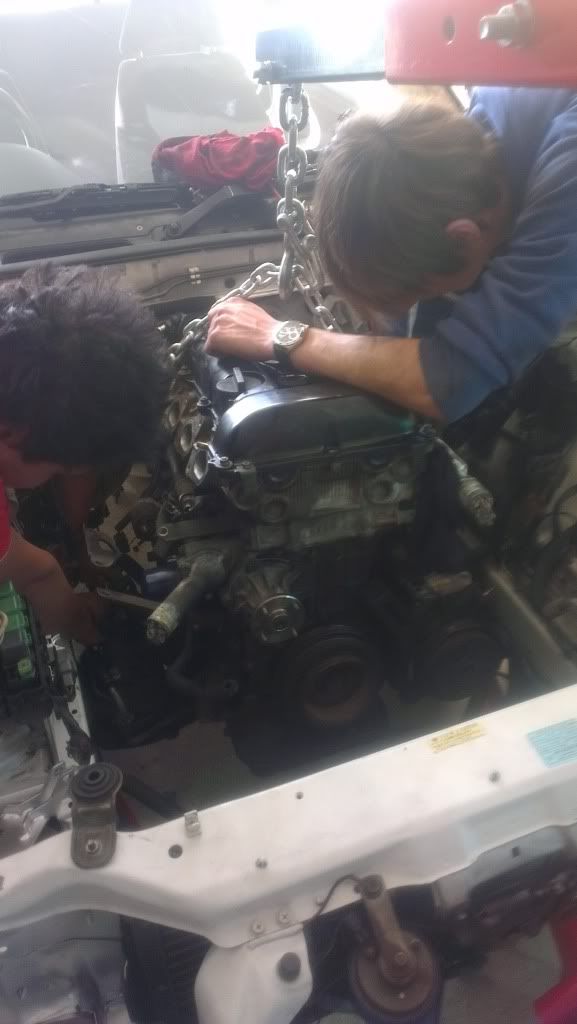

  10. frogsta
    frogsta Sleeper
    779
    Oct 5, 2011
    Mazda 6 MPS 2.3L Turbo AWD

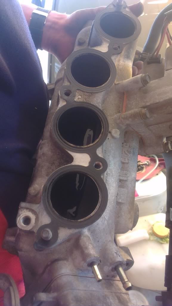

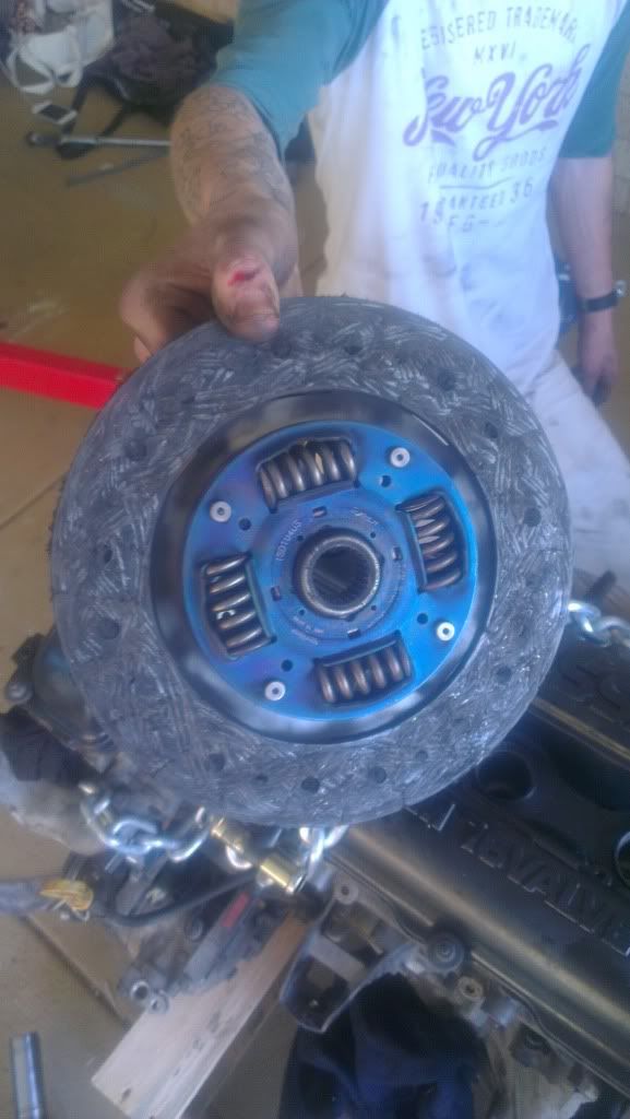

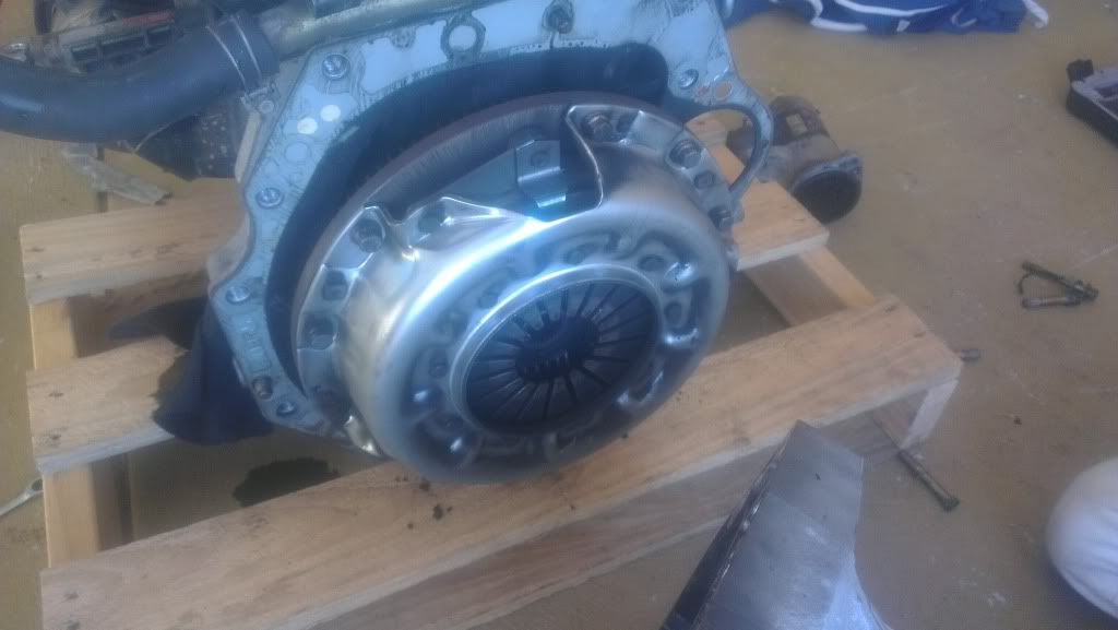

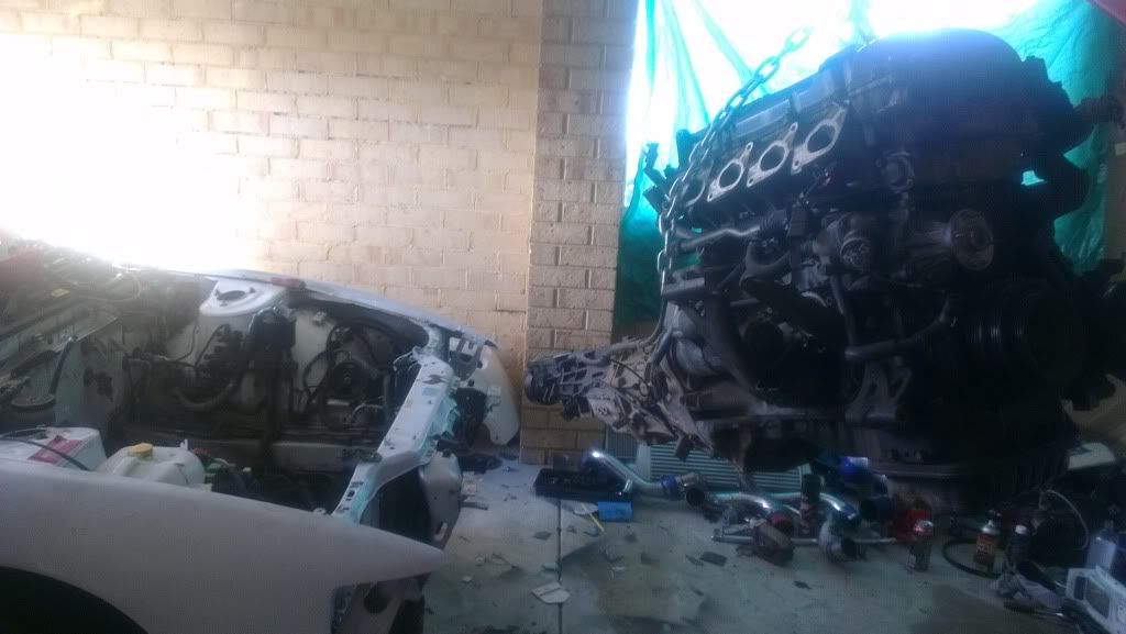

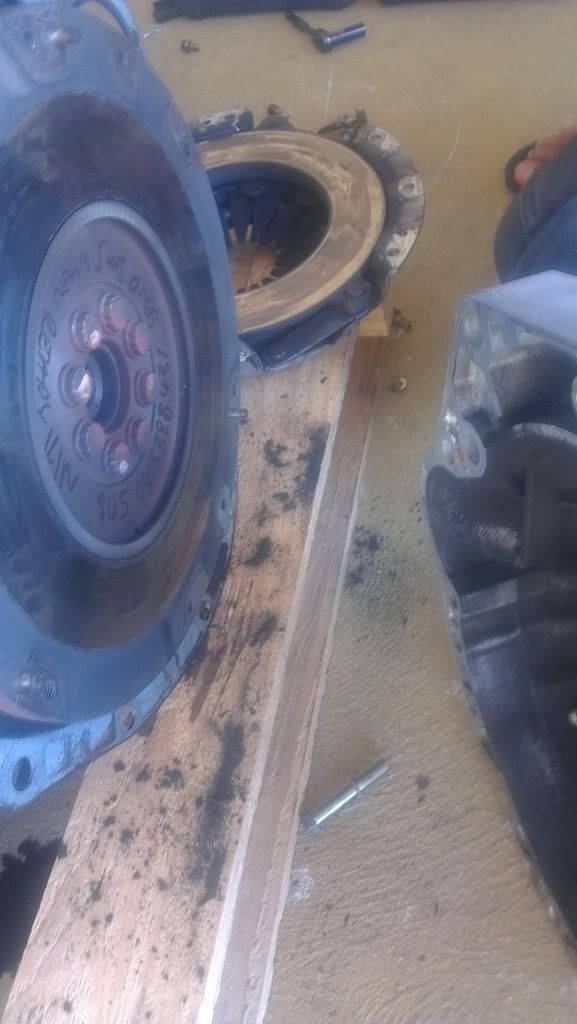

    Engine and Gearbox are out, have some pictures
    Just a litle bit of clutch fibre. As soon as gearbox was undone that smell of clutch aha, looks bad too. Oh and the shifter seal was rooted, oil everywhere around it and big split through it
    Coolant lines look good though
    The two mates of mine said that the clutch might have been wobbling because it was so thin and worn. Possibility of causing knock?

    Some engine goodies
    Any other things I should grab?
    Was hoping to get engine package tonight but not ready yet. Either tomorrow arvo or Saturday morning by the sound of it
