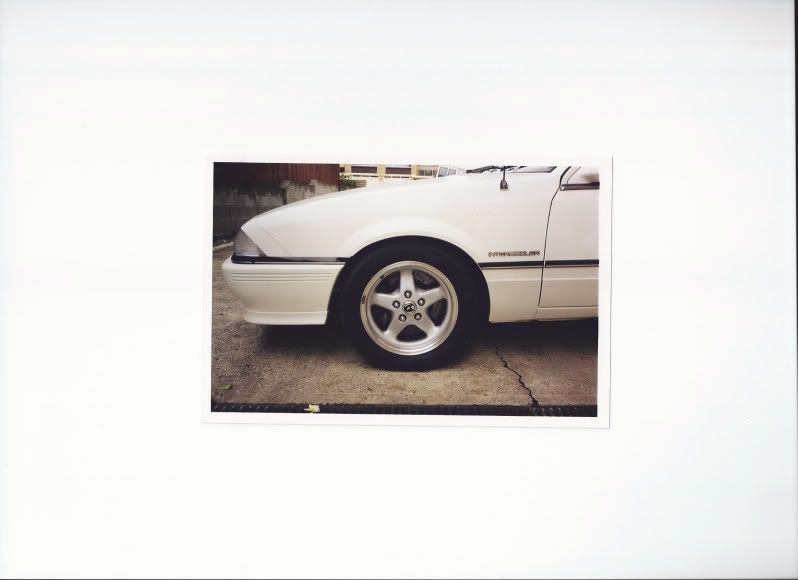

  4. Surfwagon
    Surfwagon Well-Known Member
    1,780
    42
    Jun 8, 2006
    Sydney/NSW
    AMG Mercedes C63 Wagon
    On my old VL I had VN GrpA 330 discs and calipers under 16" Walkinshaw rims and there was less than 3mm clearence but never had a problem, just make sure you dont use stick on weights in the area covered by the caliper.
