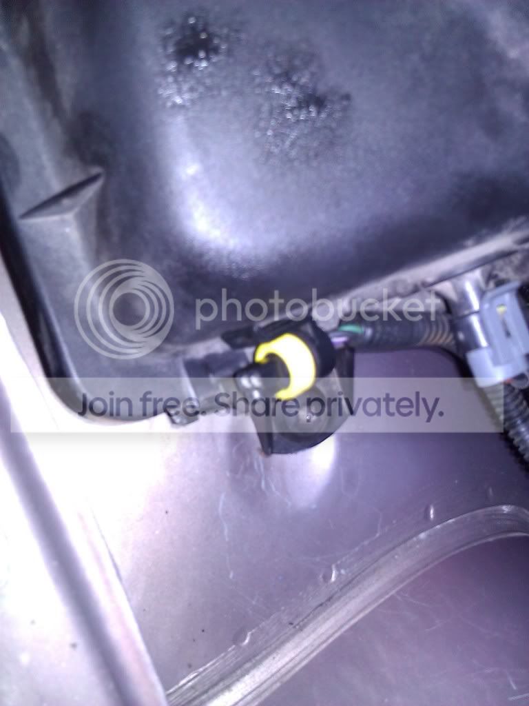

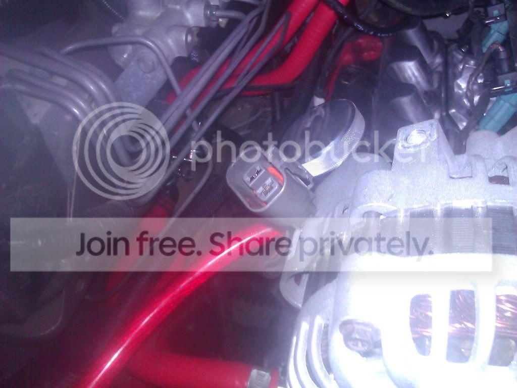

    hey guys!
    i need help...ive got a 1 wire left to connect
    its in the same loom as the alternator positive which goes into the back of the alternator
    any ides??
    also...ive replaced the heater tap, and connected the vaccum line back from the firewall but above that is another small hose. where does that go?
    any help ASAP would be most appreciated
  12. HardStyle
    HardStyle Banned
    Jul 28, 2011
    VT Turbo
    Alternator plug lol
    and that lil hose goes into the back of the plenum

  14. holden_4aw_lyfe
    holden_4aw_lyfe Tsu Tsu Tsu Tsu
    428
    Feb 11, 2009
    Twin Turbo Stroked 4.2LT VT Berlina
    alternator plug? ive never seen one of them? i changed the alternator before the engine wnet in and i didnt have to plug anything in then?

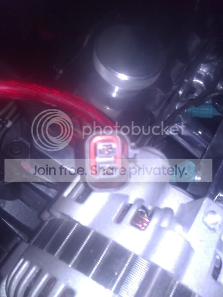

  15. holden_4aw_lyfe
    428
    Feb 11, 2009
    ok my bad it was there lol...ive got another plug...

  18. holden_4aw_lyfe
    428
    Feb 11, 2009
    hmm its not that long to go to the front of the car...
