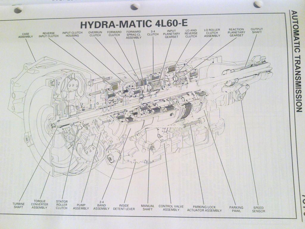

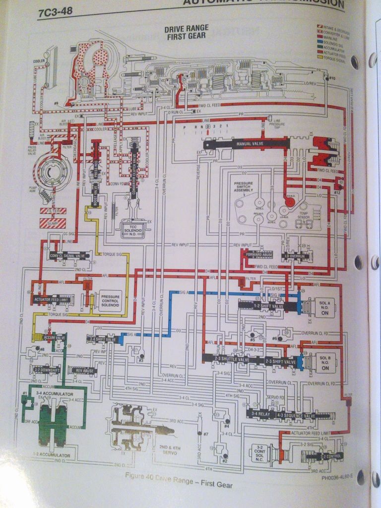

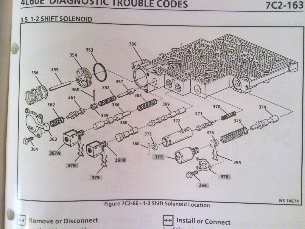

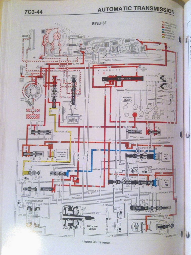

    What manuals do you have for the 4l60e,Do you have any that show the function of each component?
  6. markovr
    markovr Well-Known Member
    2,950
    102
    Nov 23, 2003
    northside brisbane
    07vessv 94vr .04vz wgn,93vp wgn,82 vhV6 wgn 88 vn
    I have the factory book on transmissions so I can send you anything if you give me what you are looking for.
