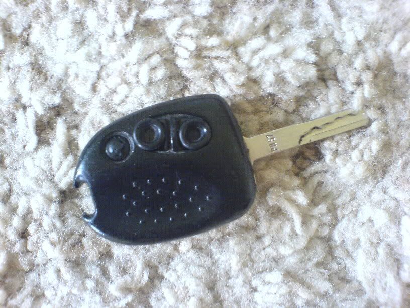

    I had a similar problem with my keys with the rubber coming off the buttons. I pulled both my keys open (a lot easier than some people think) and tried the silicon. It got very messy and I've since managed to get the silicon out and went down another route.
    I went to the hardware and picked up some rubber grommets. Was very simple to put them in and have had no problems since. Didn't need to open up the key (pity I already had, so I just sealed them back together) and only took 5 seconds to insert them

    quiksilvr3r - that's a great idea using rubber grommets. One thing I'm not sure about is how you put the grommets in as they are round and the button is a semi-circle. Is the key still water and dust proof? Thanks
