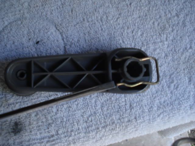

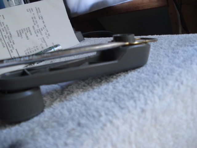

    I'll try explain how to remove the winder.
    Theres a clip that holds the winder to the mechanism tab, basically what you want to do is push it off with a long skinny sturdy flat head screwdriver.
    In the pictures below is NOT the exact same clip, but it is similar shaped but smaller (i lost the original clips when i converted lol)
    You can take a peek at the clip if you push the door card forward and pull the winder back. The clip has 2 ends what you do is use the screwdriver to push each end off, just push one end of the clip a little then push the other end so it will eventually pop off.
    ...or simply buy a winder remover tool from an auto store which i couldn't be bothered with :p
