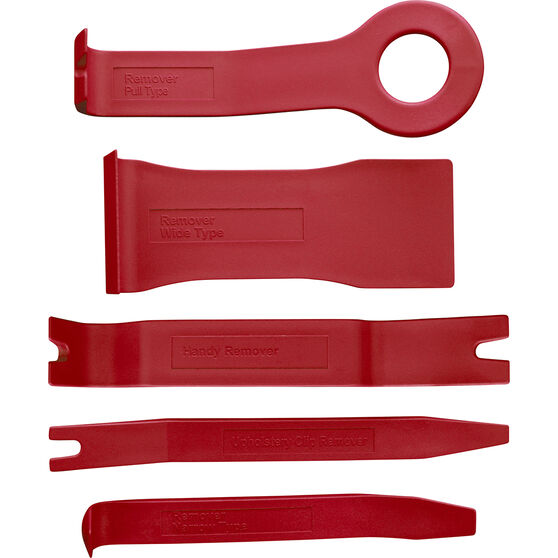

    Just don't use a screw driver as you will likely scratch / damage the plastic.
    Best to use a plastic trim removal tool like this

    The Plastic Trim Removers work perfectly, as the screw drivers leave blade marks on the trim.
